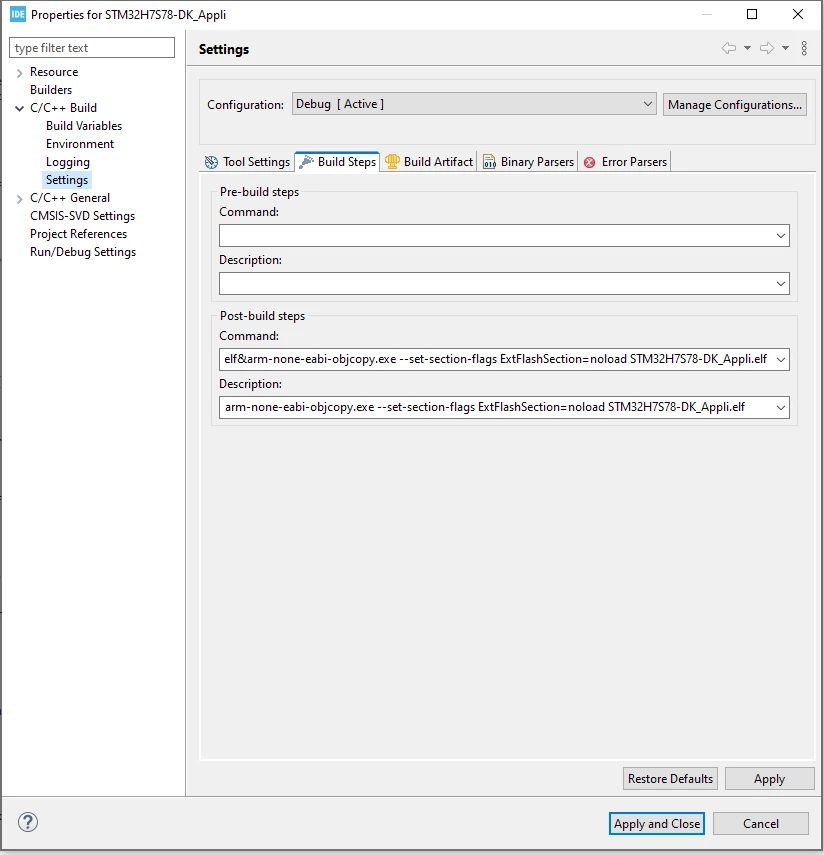

You can keep noload, but then you will have to edit the linker file and build twice to be able to extract your assets .bin.
What I meant is removing noload from the linker script, creating the .bin and then setting extflashsection to noload or removing it altogether using objcopy as I described earlier. You can automate this via post-build commands in CubeIDE:
2024-12-18 12_54_06-workspace_1.17.0 - STM32H7S78-DK_Appli_STM32H7S7L8HXH_RAMxspi1_ROMxspi2_app.ld -.png
The command I have set is:
arm-none-eabi-objcopy.exe --dump-section ExtFlashSection=images.bin STM32H7S78-DK_Appli.elf&arm-none-eabi-objcopy.exe --set-section-flags ExtFlashSection=noload STM32H7S78-DK_Appli.elf
 which should mark the section as noload after dumping the images. Again, I have not tried to flash a board, but the .bin is created for me.
You may also be able to use the normal debug and load profiles, since the file is modified as part of the build step.

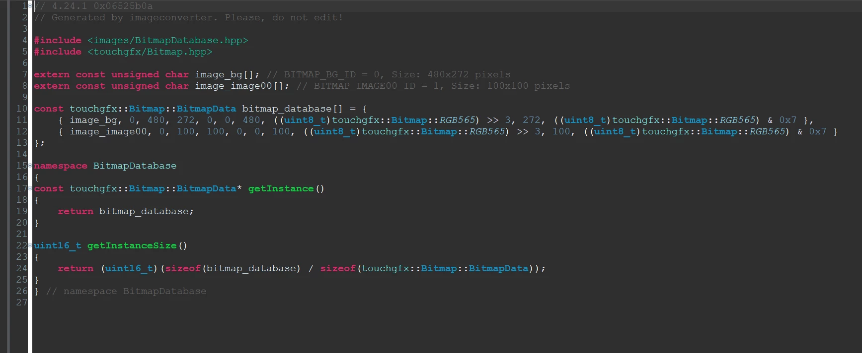

Does your .map file suggest the images are in the SD card address range?
And you BitmapDatabase.cpp?
I might suggest creating a linker section for your image buffer, so you are sure you do not overwrite anything useful. It should be uninitialized (like the frame buffers), since the SDRAM is not available at boot time.
I might suggest setting an image or two to be in internal flash in the images tab in TouchGFX designer, and see if they show up.
You could try to put a single image of a solid colour (on the SD card) in your project and draw only that image. Then break at the end of your block copy function and see if the memory contents match your expectation.
Finally, I can see that your image cache is the same size as your SD card region. You could also try the suggested procedure at the bottom here: Using Non-Memory Mapped Flash for Storing Images | TouchGFX Documentation
Dec 2, 2024 2:13 PM UTC
Yes, my .map file suggest that the images are in the SDcard Address range.
This is my BitmapDatabase.cpp file.
Thanks, I'll try your options.
Dec 18, 2024 1:36 PM UTC
Finally I can say that this is now working. Thank you very much for the help.
