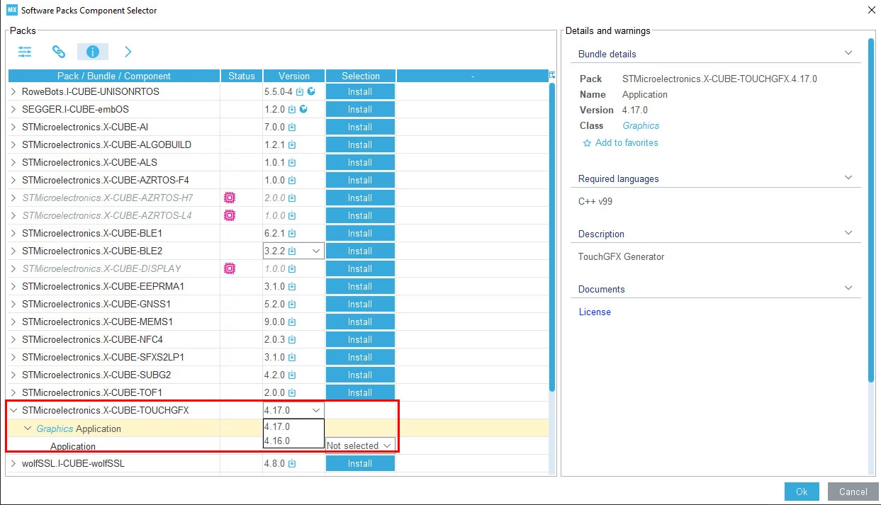

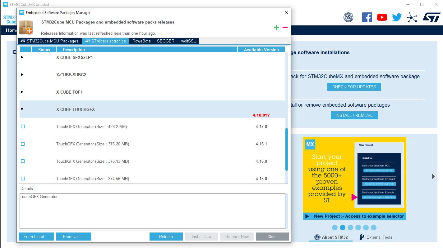

How to add TouchGFX 4.18 to STM32CudeIDE and MX?
Hi. I've followed the installation guidance found at https://support.touchgfx.com/docs/introduction/installation and can't get TouchGFX 4.18 to show up in neither STM32CudeIDE and STM32CudeMX (refreshed several times). Will this show up when an update list gets updated or is this a permanent removal from the ST's IDE toolchain? Thanks

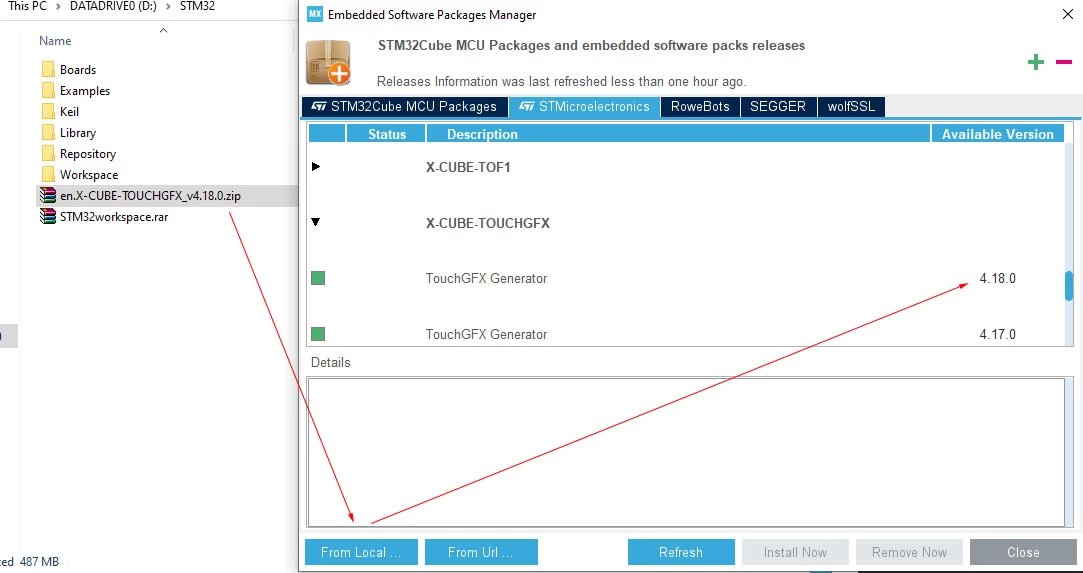

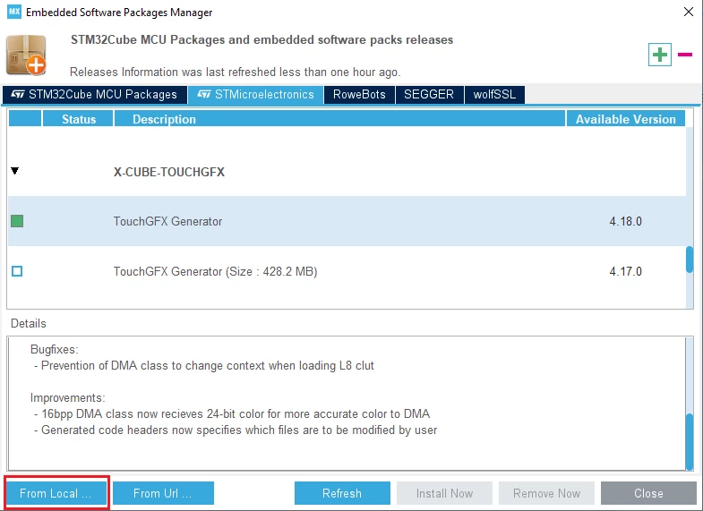

Try to import the zip file manually. You just need to click on "From Local" and then select the zip file that you downloaded from https://www.st.com/en/embedded-software/x-cube-touchgfx.html

I am able to see it on my side this is surprising. What version of STM32CubeMX are you using ?
You can always download it from ST's website and use the "From Local" option in the bottom left of your screenshot to install TouchGFX 4.18.0

As requested, here's the list of my environment. Assuming there is a problem with the 1.7.0 version or installation, would you recommend uninstalling the entire IDE & MX toolchain and attempting a new installation to see if this fix the issue?
STM32CubeIDE
Version: 1.7.0
Build: 10852_20210715_0634 (UTC)
OS: Windows 10, v.10.0, x86_64 / win32
Java version: 11.0.10
STM32CubeMX 6.3.0

Thank you for the guidance Sara. Worked perfectly.
Mecanix
MecanixAuthor
October 26, 2021
*Note*
After a manual From Local install; and if you can't find the 4.18.0 listed as per visual, initiate a Refresh from the active window, close CubeIDE/MX, and restart the session. Should appear at next start...
