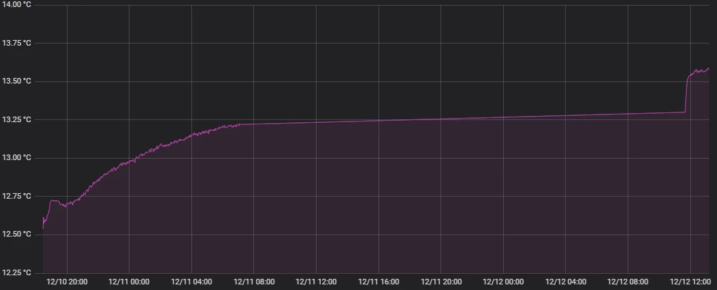

I apologize for the unclear question.  I want to know how to add label like you said : 1970-01-01 00:00:01. For example: we measure temperature every  15 seconds so when temperature is measured i want to add point in graph with corresponding timestamp which is shown on x axis. Is there any example on how to do that ?
Here is a example of what I want:
