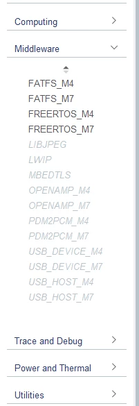

Thank you for your answer. I spend two weeks (with 25++ years practice in 8/16/32-bit MCU-s with SiliconLabs, TI MCUs) but I could not add the STemWin library to a new project on STM32H747I-DISCO board. Even printing on the screen did not work in the beginning with the "factory example STemWin_HelloWorld". Now I can print on the LCD but the touch screen still does not recognize the buttons on the screen.
I know and I read the AN4223 app notes but it did not help too much.
I also tried to use STR32CubeMX app to add the STemWin library. I selected STM32H747I-DISCO board, but it does not contain STemWin middleware:
0693W00000D1cexQAB.pngCan you tell me what I am doing wrong?

Hi @Louis Balázs​ ,
We do apologize for the delay we take to answer sometimes, as we are in the summer period vacation.
In fact, STemWin was removed from CubeMX since V5.5 release.
So, STemwin is not supported in CubeMx.
I will check internally your ticket and come back to you soon with update.
Imen
