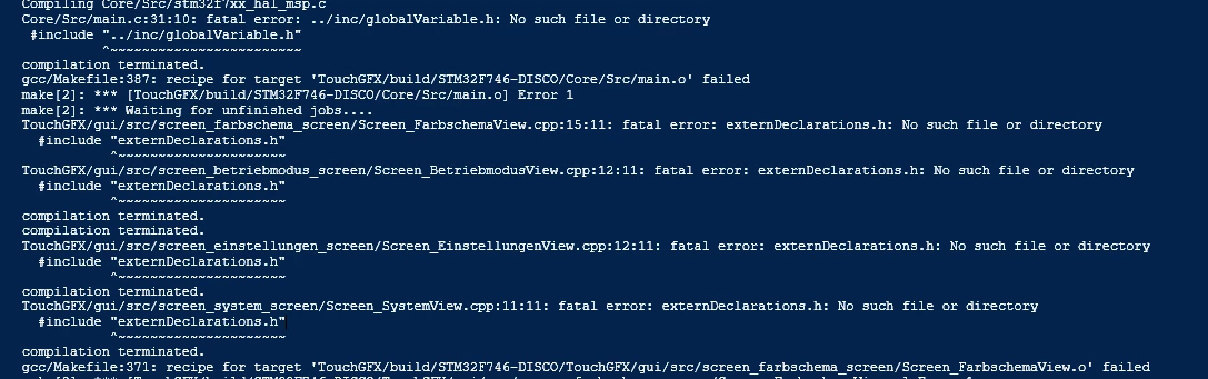

How to add my Header Files in GFXTouch
I'm having trouble inserting my own header files. No error is displayed in the STM32IDE when compiling, but when I compile in the GFXTouch, the errors are in GFXTouch.png.

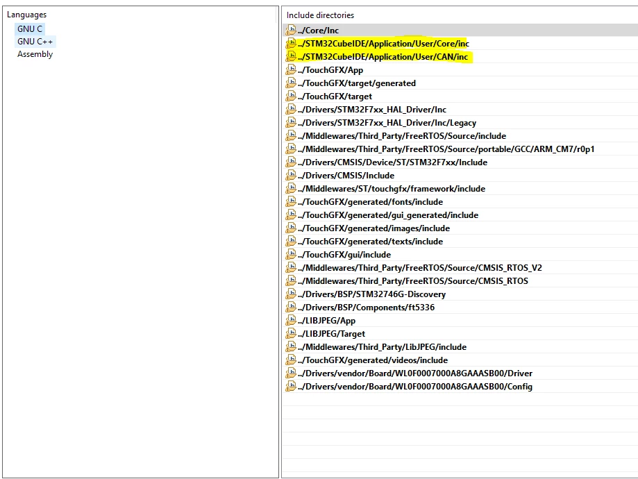

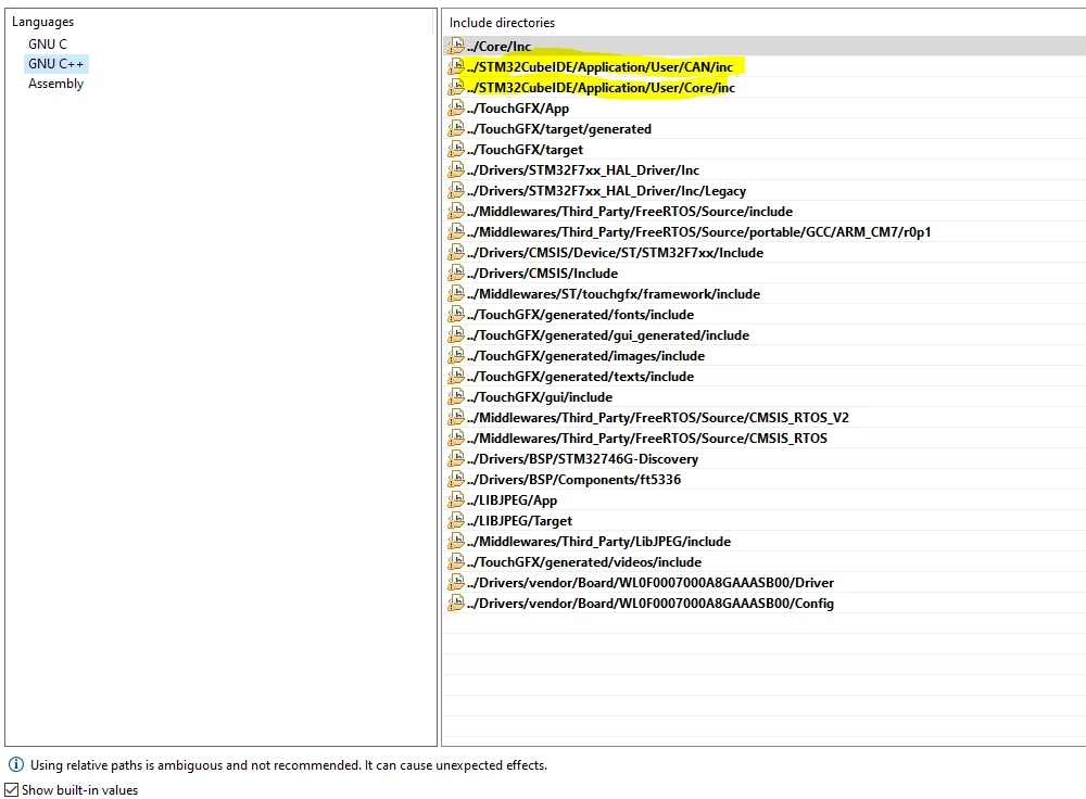

I've already included the paths include in c and c++. How can I include my header files in GFXTouch.

Hello PHolz.1,
I think you need to modify your Makefile to include your own headers. It's located in gcc folder.
/Osman
