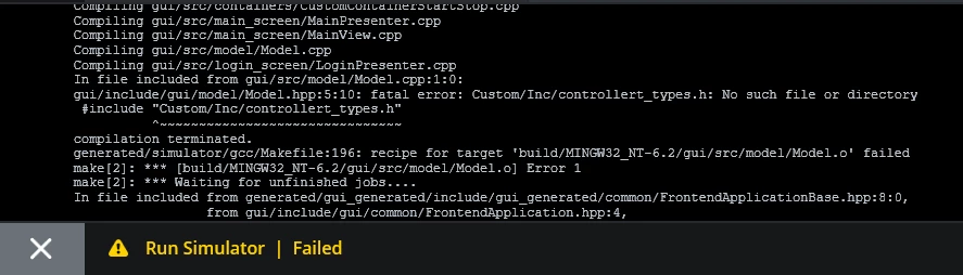

How to add custom header in touch-gfx to run with simulator?
hi,
I'm trying to add a cutom header in a touchgfx project. this works in the cube ide, but not in the simulator. The header file only contains structure definitions. Get this error message:
1 reply
Romain DIELEMAN
Jan 27, 2023 5:24 AM UTC
You need to add the path to the simulator's makefile in TouchGFX/simulator/gcc folder so that the prokect is aware of what file you are referring too.
