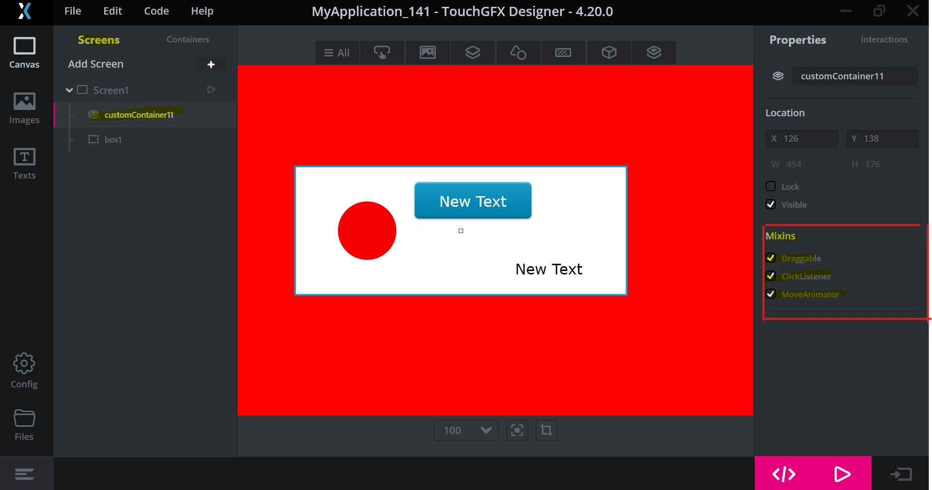

Hello all,
I create a custom container and need to used click/drag/gesture event,
but the handleClickEvent/handleDragEvent/handleGestureEvent cannot trigger in it.
How can get these event in custom container?

Hi V.H,
Do you mean you want to handle click/drags with your entire container (and not just elements inside it ?)
If yes, you just need to click on your container inside your screen and check the boxes "Draggable", "ClickListener", and "Move Animator" under Mixins in the right panel (Properties).
Then you implements the functions you need when triggered. You can be helped by our article here.
/Osman

ktrofimo
Senior III
August 25, 2022
I was thinking the same and even sent a link to the same article, but this is not what author wants. Our idea is to drag the whole object on the screen while he needs gestures to change value inside control, but not the position of this control. Like a spin buttons besides numeric field in MFC. When you click this button and move mouse up or down this changes value in a numeric field.
