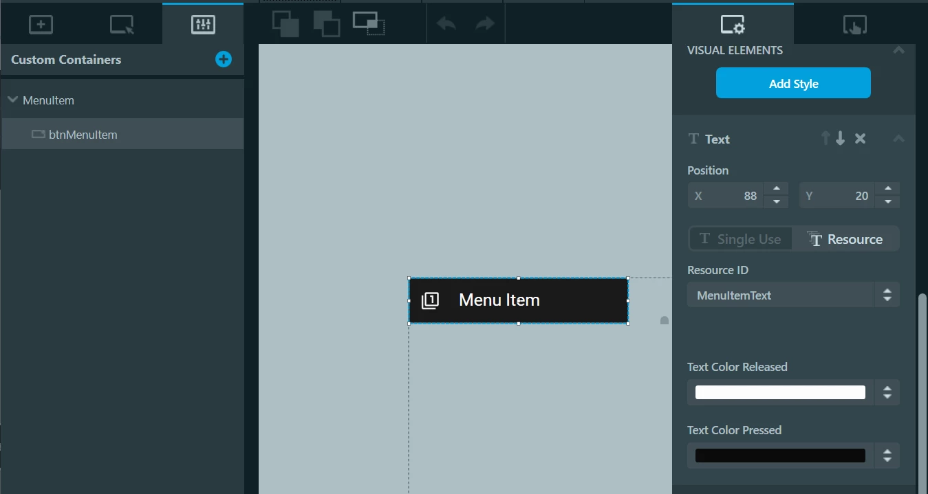

0693W000003PDPQQA4.pngHow does one create a Flex Button w/ wildcard in the designer then? I don't see that option. I have a container called MenuItem with a single component - a flex button. I need to be able to change this text on the fly using Unicode string commands.

You don't have the wildcard possibility because your resource MenuItemText has no wildcard.
You have to add a <> in the text field of your resource to indicate there is a wildcard.
