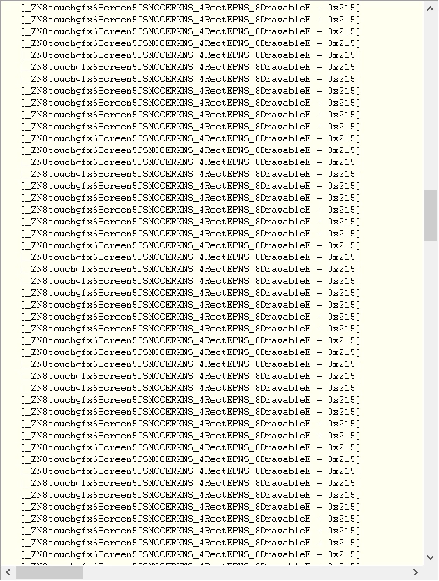

How the Screen::JSMOC(const Rect & invalidatedArea,Drawable * widgetToDraw) works?
  • February 21, 2020
  • 1591 views
I have some trouble with the JSMOC method.
In my application,one screen could contain many(over 3000) widgets.Because of the recursive JSMOC function,it can easily cause a stack overflow.
Like this:

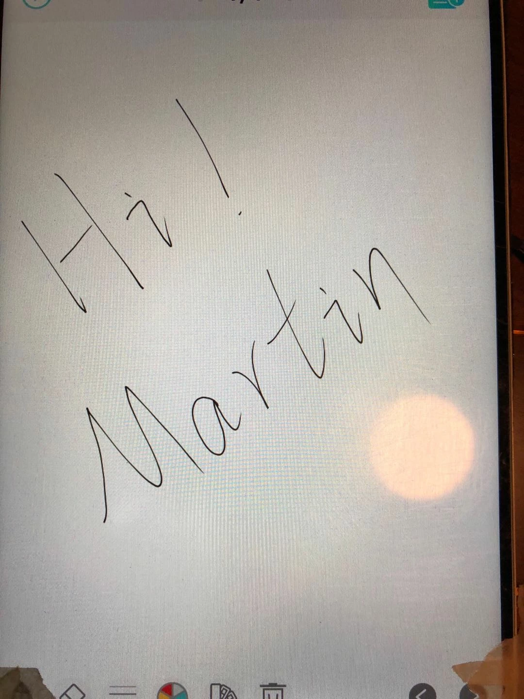

Why do you have this many? Seems unreasonable. I feel we can optimize something in this application : ) Tell me about it?
/Martin
nico's cat
February 21, 2020
Hi Martin.
Our product is a writing pad.The more you write the more widgets will be added to the screen.
Here is the product.
0690X00000DC5WhQAL.jpgWhat is clear is that recursion caused a stack overflow.
​Looking forward to your reply.
