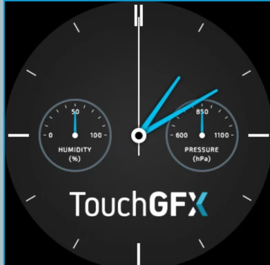

Hello;
I try to undestand touch gfx watch application. I could not understand how the pressure arrow is rotating without any interaction algorithm. Is the rotation of texture map related with orego? What makes the 2 step forward and 1 step backward, how can achieve this in a new created texture map?

The project name is TouchGfx Watch. I use stm32h7 series. I wonder how the pressure line moves like this.

If you look at the code, you'll see that the pressure needle is an Animation Texture Mapper and every x seconds, we setup an animation for the needle. Here is the code related to the pressure needle :
pressureEntropi = (((seconds + minutes + hours) * (seconds + minutes + hours)) % 180) / 360.0f * 2 * PI - PI / 2;
pressure.setupAnimation(AnimationTextureMapper::Z_ROTATION, pressureEntropi, 250, 0, EasingEquations::cubicEaseInOut);
pressure.startAnimation();
And the prototype of setupAnimation() is as follows :
 * Sets up the animation for a specific parameter (angle/scale) for the next animation.
 * The specific parameter is chosen using the AnimationType enum. AnimationTypes that
 * are not setup using this method will keep their value during the animation.
 * @param parameter The parameter of the TextureMapper that should be animated.
 * @param endValue The end value for the parameter.
 * @param duration The duration for the animation of the parameter. Specified in
 * ticks.
 * @param delay The delay before the animation of the parameter starts.
 * Specified in ticks.
 * @param progressionEquation (Optional) the progression equation for the animation of this
 * parameter. Default is EasingEquations::linearEaseNone.
 virtual void setupAnimation(AnimationParameter parameter, float endValue, uint16_t duration, uint16_t delay, EasingEquation progressionEquation = &EasingEquations::linearEaseNone);
You can find all this information yourself by going through the code and looking at AnimationTextureMapper.hpp/.cpp
