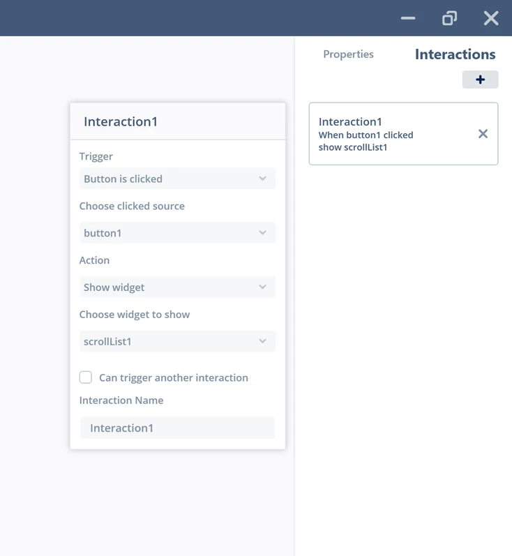

how pop up scrolllist when a button is clicked

Hello @MA.2​ ,
There is a very easy way to do what you want using TouchGFXDesigner widgets interactions :
  • Click on "Add Interaction"
  • Create an interaction for your button, with trigger "Button is clicked", action "Show widget" and widget to show "ScrollList1".
Don't forget to uncheck the "Visible" checkbox inside the properties of your ScrollList, so it can appear only when the button is pressed, and not before.
Hope that this helped you,
/Yoann
