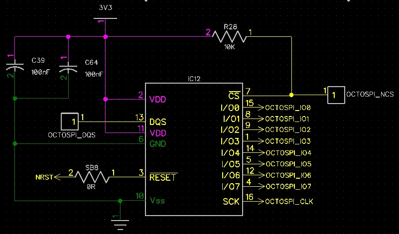

I am using below development tools
MCU: STM32H7B3IIT6
IDE: STM32CubeIDE Version: 1.8.0
GUI: TouchGFX Version: 4.18.1
SDRAM: IS45S16800F-7CTLA1-TR
FLASH: MX25LM51245GMI00
Schematic

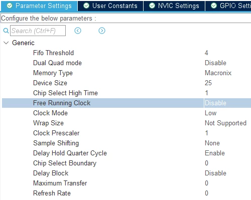

static void MX_OCTOSPI1_Init(void)
 /* USER CODE BEGIN OCTOSPI1_Init 0 */
 /* USER CODE END OCTOSPI1_Init 0 */
 OSPIM_CfgTypeDef sOspiManagerCfg = {0};
 /* USER CODE BEGIN OCTOSPI1_Init 1 */
 /* USER CODE END OCTOSPI1_Init 1 */
 /* OCTOSPI1 parameter configuration*/
 hospi1.Instance = OCTOSPI1;
 hospi1.Init.FifoThreshold = 1;
 hospi1.Init.DualQuad = HAL_OSPI_DUALQUAD_DISABLE;
 hospi1.Init.MemoryType = HAL_OSPI_MEMTYPE_MICRON;
 hospi1.Init.DeviceSize = 26;
 hospi1.Init.ChipSelectHighTime = 2;
 hospi1.Init.FreeRunningClock = HAL_OSPI_FREERUNCLK_DISABLE;
 hospi1.Init.ClockMode = HAL_OSPI_CLOCK_MODE_0;
 hospi1.Init.WrapSize = HAL_OSPI_WRAP_NOT_SUPPORTED;
 hospi1.Init.ClockPrescaler = 3;
 hospi1.Init.SampleShifting = HAL_OSPI_SAMPLE_SHIFTING_NONE;
 hospi1.Init.DelayHoldQuarterCycle = HAL_OSPI_DHQC_DISABLE;
 hospi1.Init.ChipSelectBoundary = 0;
 hospi1.Init.ClkChipSelectHighTime = 0;
 hospi1.Init.DelayBlockBypass = HAL_OSPI_DELAY_BLOCK_BYPASSED;
 hospi1.Init.MaxTran = 0;
 hospi1.Init.Refresh = 0;
 if (HAL_OSPI_Init(&hospi1) != HAL_OK)
 Error_Handler();
 sOspiManagerCfg.ClkPort = 1;
 sOspiManagerCfg.DQSPort = 1;
 sOspiManagerCfg.NCSPort = 1;
 sOspiManagerCfg.IOLowPort = HAL_OSPIM_IOPORT_1_LOW;
 sOspiManagerCfg.IOHighPort = HAL_OSPIM_IOPORT_1_HIGH;
 if (HAL_OSPIM_Config(&hospi1, &sOspiManagerCfg, HAL_OSPI_TIMEOUT_DEFAULT_VALUE) != HAL_OK)
 Error_Handler();
 /* USER CODE BEGIN OCTOSPI1_Init 2 */
 BSP_OSPI_NOR_Init_t Flash;
 Flash.InterfaceMode = BSP_OSPI_NOR_OPI_MODE;
 Flash.TransferRate = BSP_OSPI_NOR_DTR_TRANSFER;
 BSP_OSPI_NOR_DeInit(0);
 int32_t RetVal = BSP_OSPI_NOR_Init(0, &Flash);
 if(RetVal != BSP_ERROR_NONE)
 Error_Handler();
 RetVal = BSP_OSPI_NOR_EnableMemoryMappedMode(0);
 Error_Handler();
 /* USER CODE END OCTOSPI1_Init 2 */

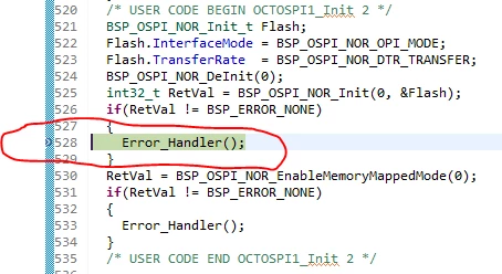

I am trying to activate octospi as custom board design, but the program gives an error. The program gets an error at the following place? What do you think could be the reason?

Hello @Osman SOYKURT​ This fonction returned -5 value. RetVal = -5
and BSP_ERROR_NONE value is 0. This function must return 0 value. So program goes Error_Handler()'s function
Tesla DeLorean
Guru
March 4, 2022
Wouldn't you just debug/instrument your BSP_OSP_NOR_Init() implementation to understand where inside that it failed?
Work backward to the point that generated the error return.
Freedom_Neo
Senior
March 7, 2022
Hello @Community member​ BSP_OSP_NOR_Init()'s function returned -5 value. So This function must returned 0 value because

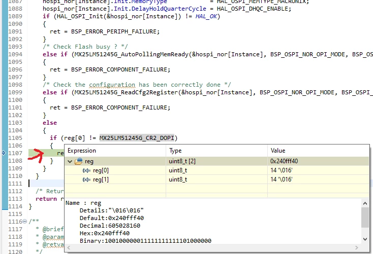

Freedom_Neo
Senior
March 7, 2022
This problem occurs below in stm32h7b3i_discovery_ospi.c source file
#define BSP_ERROR_COMPONENT_FAILURE -5

 * @brief This function enables the octal DTR mode of the memory.
 * @param Instance OSPI instance
 * @retval BSP status
static int32_t OSPI_NOR_EnterDOPIMode(uint32_t Instance)
 int32_t ret = BSP_ERROR_NONE;
 uint8_t reg[2];
 /* Enable write operations */
 if (MX25LM51245G_WriteEnable(&hospi_nor[Instance], Ospi_Nor_Ctx[Instance].InterfaceMode, Ospi_Nor_Ctx[Instance].TransferRate) != MX25LM51245G_OK)
 ret = BSP_ERROR_COMPONENT_FAILURE;
 /* Write Configuration register 2 (with new dummy cycles) */
 else if (MX25LM51245G_WriteCfg2Register(&hospi_nor[Instance], Ospi_Nor_Ctx[Instance].InterfaceMode, Ospi_Nor_Ctx[Instance].TransferRate, MX25LM51245G_CR2_REG3_ADDR, MX25LM51245G_CR2_DC_6_CYCLES) != MX25LM51245G_OK)
 else if (MX25LM51245G_WriteEnable(&hospi_nor[Instance], Ospi_Nor_Ctx[Instance].InterfaceMode, Ospi_Nor_Ctx[Instance].TransferRate) != MX25LM51245G_OK)
 /* Write Configuration register 2 (with Octal I/O SPI protocol) */
 else if (MX25LM51245G_WriteCfg2Register(&hospi_nor[Instance], Ospi_Nor_Ctx[Instance].InterfaceMode, Ospi_Nor_Ctx[Instance].TransferRate, MX25LM51245G_CR2_REG1_ADDR, MX25LM51245G_CR2_DOPI) != MX25LM51245G_OK)
 else
 /* Wait that the configuration is effective and check that memory is ready */
 HAL_Delay(MX25LM51245G_WRITE_REG_MAX_TIME);
 /* Reconfigure the memory type of the peripheral */
 hospi_nor[Instance].Init.MemoryType = HAL_OSPI_MEMTYPE_MACRONIX;
 hospi_nor[Instance].Init.DelayHoldQuarterCycle = HAL_OSPI_DHQC_ENABLE;
 if (HAL_OSPI_Init(&hospi_nor[Instance]) != HAL_OK)
 ret = BSP_ERROR_PERIPH_FAILURE;
 /* Check Flash busy ? */
 else if (MX25LM51245G_AutoPollingMemReady(&hospi_nor[Instance], BSP_OSPI_NOR_OPI_MODE, BSP_OSPI_NOR_DTR_TRANSFER) != MX25LM51245G_OK)
 /* Check the configuration has been correctly done */
 else if (MX25LM51245G_ReadCfg2Register(&hospi_nor[Instance], BSP_OSPI_NOR_OPI_MODE, BSP_OSPI_NOR_DTR_TRANSFER, MX25LM51245G_CR2_REG1_ADDR, reg) != MX25LM51245G_OK)
 else
 if (reg[0] != MX25LM51245G_CR2_DOPI)
 /* Return BSP status */
 return ret;

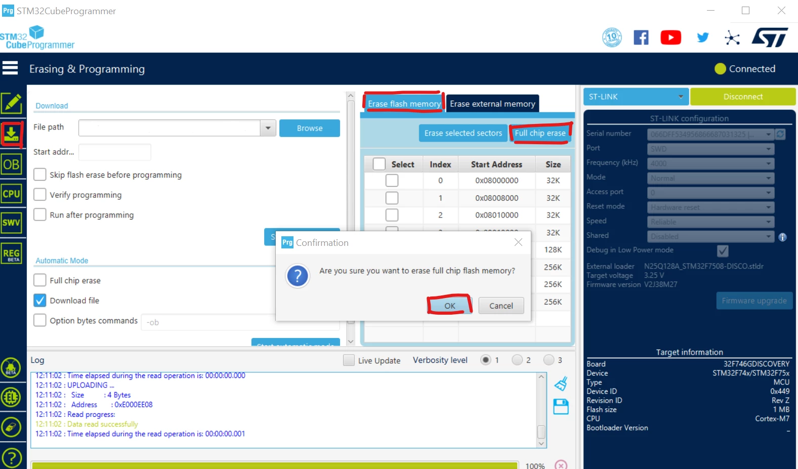

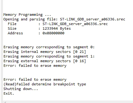

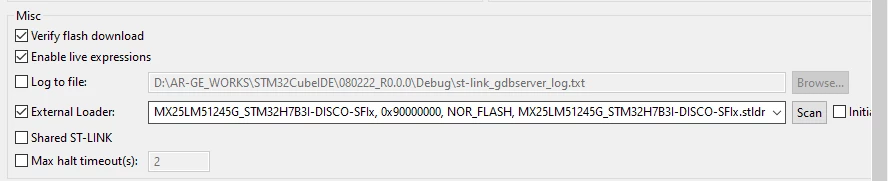

Hi Everyone,
I've made progress. But I am getting an error while uploading. What do you think could be the reason?

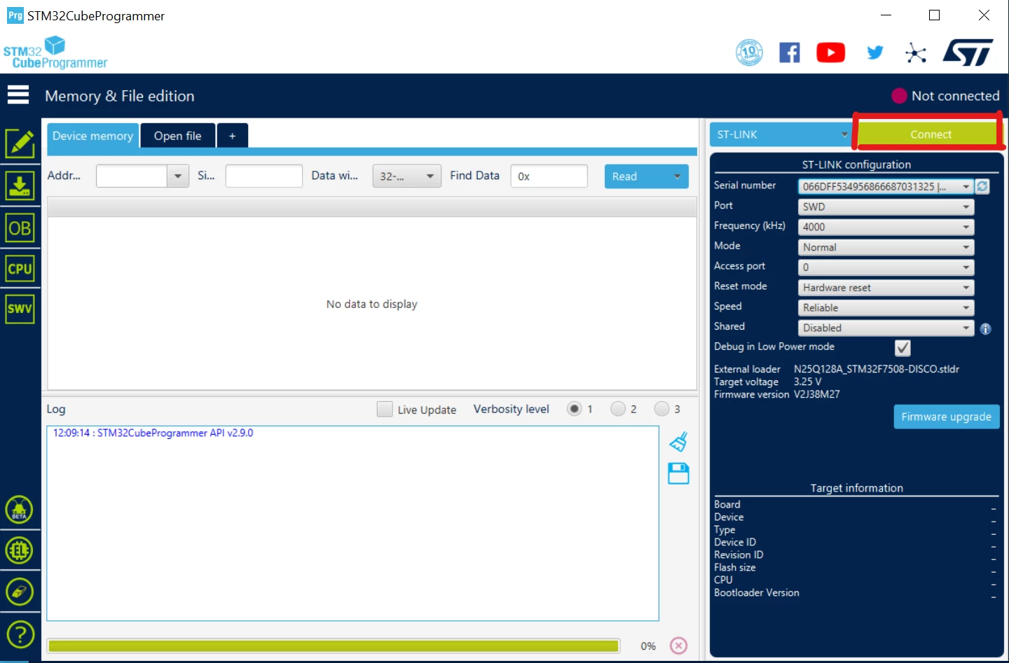

Osman SOYKURT
March 7, 2022
Hello Freedom_Neo,
We have a software called STM32CubeProgrammer that can help you erasing your memory. You can try to install it and then follow this steps :
1- Connect your board to your PC and click on "Connect" button (top right)
2- Click on the 2nd button on the left panel (with the arrow) and click on "Erase flash memory" and "Full chip erase".
3) If you want to erase your external memory, you can do the same with "Erase external memory"
You can also try to remove your breakpoints as it says there is a error with them.
/Osman

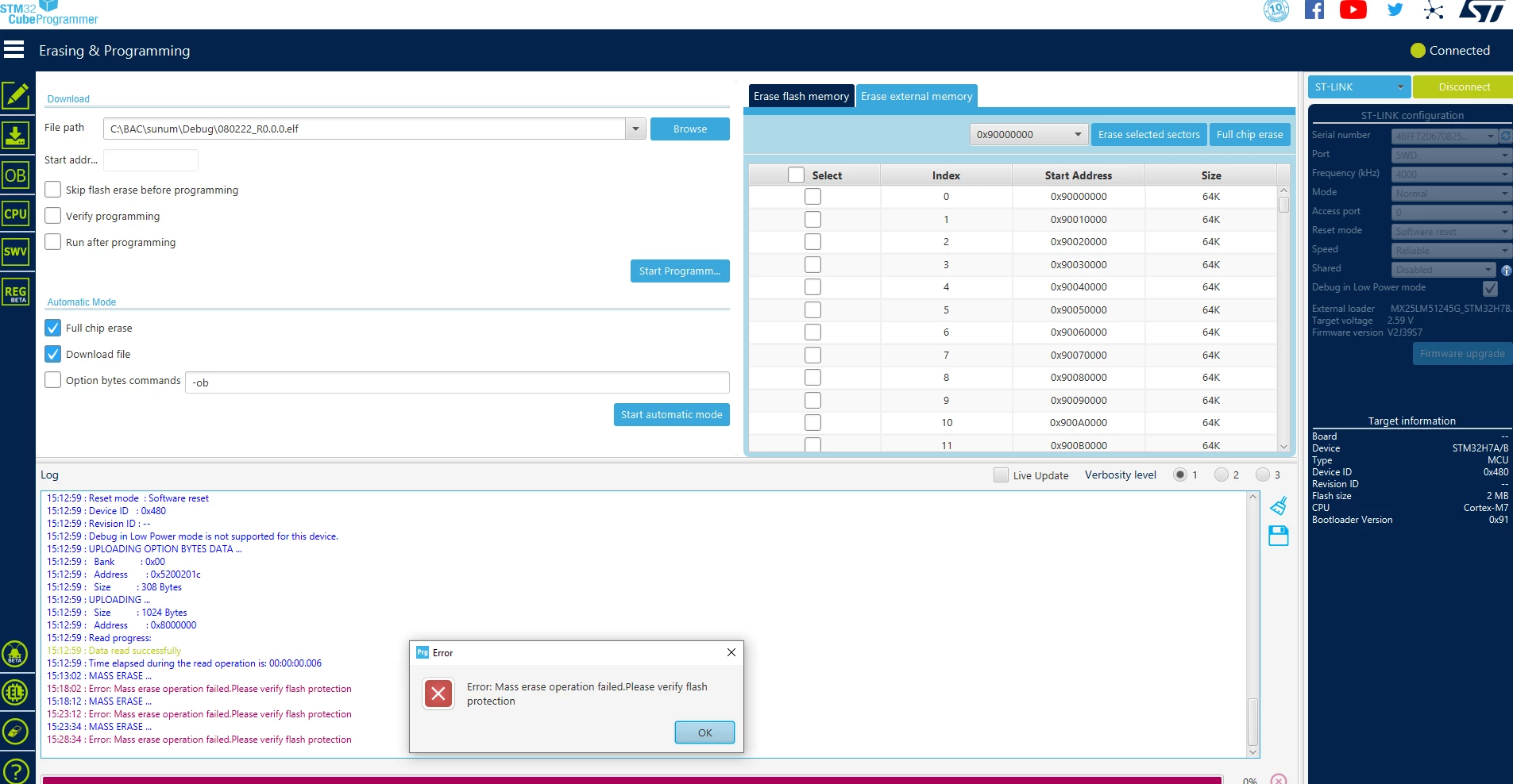

Freedom_Neo
Senior
March 7, 2022
Hi @Osman SOYKURT​
I did 1. and 2. steps. But The failure accurs 3. step. The deletion process takes 4-5 minutes, but at the end it gives an error as follows.
Dont have any breakpoint anywhere

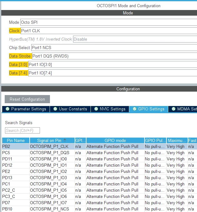

Freedom_Neo
Senior
March 11, 2022
Dear @Community member​ Thank you for support. I am using below pins.
// STM32H7B3IIT6 PIN CHART
// MX25LM51245GMI00 (16-PIN SOP)
// OCTOSPIM P1
// D0 PD11:AF9
// D1 PD12:AF9
// D2 PE2:AF9
// D3 PD13:AF9
// D4 PC1:AF10
// D5 PC2:AF11
// D6 PC3:AF11
// D7 PD7:AF10
// CLK PB2:AF9
// NCLK NOT USED
// NCS PB10:AF9
// DQS PC5:AF10
PChia.2237
