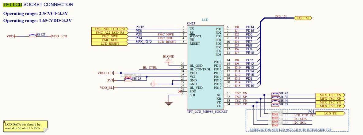

Hello @Badam.17 (Community Member)​ ,
There is no LTDC in STM32U5, it's connected via FMC.
Please have a look at the schematic available here in the ST web site.
Check also the LCD connection in the UM2854 Evaluation Board with STM32U575AI MCU.
By the way STM32L4 has no LTDC too, only STM32L4+ has LTDC (STM32F4/F7/H7 with LTDC also).

Hi
I'm new to the STM32Cube Ecosystem (used mbed OS with STM32 MCUs up to now). I'm also interested in using a TFT-LCD screen (240x320px) via FMC (and ideally DMA). Is there an example (or will there be an example) for using a LCD with the U5 sometime soon? I already tried to do my own project/code but I don't get it running.
As I'm new to STM32Cube: Is there some detailed documentation for the HAL/LL Drivers (only found UM2911 but it doesn't show which arguments are needed for which function of the HAL/LL drivers). A documentation for BSP (lcd) drivers would also be highly appreceated :)
