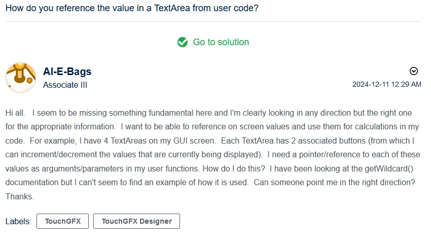

Hi all.   I seem to be missing something fundamental here and I'm clearly looking in any direction but the right one for the appropriate information.  I want to be able to reference on screen values and use them for calculations in my code.  For example, I have 4 TextAreas on my GUI screen.  Each TextArea has 2 associated buttons (from which I can increment/decrement the values that are currently being displayed).  I need a pointer/reference to each of these values as arguments/parameters in my user functions. How do I do this?  I have been looking at the getWildcard() documentation but I can't seem to find an example of how it is used.  Can someone point me in the right direction?  Thanks.

If you are increasing/decreasing the value using a button increment/decrement a variable in the button callback and use that value for your calculation.
If you need to dispatch that value to model.cpp, you need to pass it over the presenter.
Example:
In the View.cpp:
void MainScreenView::increaseValue()
 temperature++;
 presenter->NewTemperatureSettingRequested(temperature);
void MainScreenView::decreaseValue()
 temperature--;
In the ppresenter.cpp:
void MainScreenPresenter::NewTemperatureSettingRequested(int temperature)
 model->NewTemperatureSettingRequested(temperature);
In model.cpp:
void Model::NewTemperatureSettingRequested(int temperature)
 /* Do what you want here or send it to the low layer for calculation */

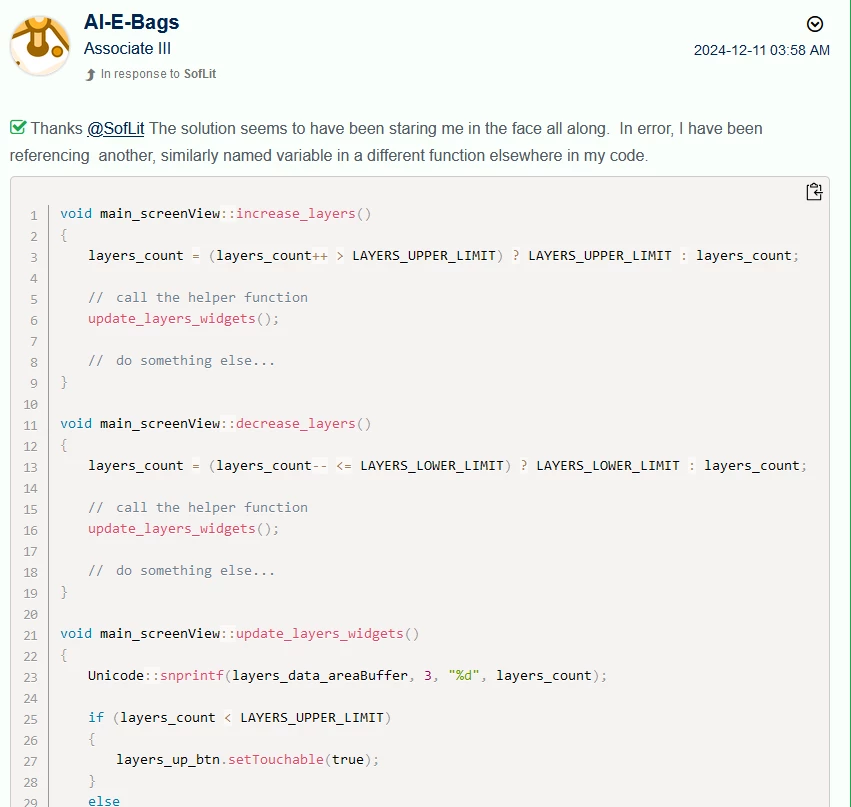

Thanks @mƎALLEm The solution seems to have been staring me in the face all along.  In error, I have been referencing  another, similarly named variable in a different function elsewhere in my code.
void main_screenView::increase_layers()
	layers_count = (layers_count++ > LAYERS_UPPER_LIMIT) ? LAYERS_UPPER_LIMIT : layers_count;
	//	call the helper function
	update_layers_widgets();
	//	do something else...
void main_screenView::decrease_layers()
	layers_count = (layers_count-- <= LAYERS_LOWER_LIMIT) ? LAYERS_LOWER_LIMIT : layers_count;
void main_screenView::update_layers_widgets()
	Unicode::snprintf(layers_data_areaBuffer, 3, "%d", layers_count);
	if (layers_count < LAYERS_UPPER_LIMIT)
		layers_up_btn.setTouchable(true);
	else
		layers_up_btn.setTouchable(false);
	if (layers_count > LAYERS_LOWER_LIMIT)
		layers_down_btn.setTouchable(true);
	else
		layers_down_btn.setTouchable(false);
	// Invalidate the data areas to refresh the display
	layers_data_area.invalidate();
	layers_up_btn.invalidate();
	layers_down_btn.invalidate();
 I adapted the above functions from one of the TouchGFX examples a while back and then proceeded to forget all about them! I needed to re-focus and your suggestions made me do just that.  Please explain the benefits involved in dispatching these values to model.cpp and passing them over to the presenter, I'd be interested to learn.
