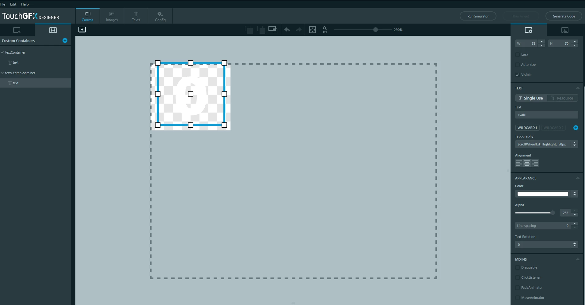

0693W000006G0vrQAC.pngThank you for your very fast reply. I created a custom container and in the "Text-line", I used a wildcard instead one text or multiple complicated structure, as you suggested.
I already used this custom contaier as a Item template in scrollwheel widgest as you suggested.
The issue is more, that I cannot/don't know how to initialize these values in the STM32CubeIDE.

After you create custom container in size what you need, generate code and in ide open container cpp file.
Here you need create methods for setup all in one line , here only text. I havnt example for text but i use buttons, then
void MenuItem::selit(bool sel)
	if(sel) buttonWithLabel1.setBitmaps(touchgfx::Bitmap(BITMAP_MENU_SEL_ID), touchgfx::Bitmap(BITMAP_MENU_SEL_ID));
	else buttonWithLabel1.setBitmaps(touchgfx::Bitmap(BITMAP_MENU_NOSEL_ID), touchgfx::Bitmap(BITMAP_MENU_SEL_ID));
void MenuItem::markit(bool sel)
	if(sel) buttonWithLabel1.setLabelColor(touchgfx::Color::getColorFrom24BitRGB(255, 255, 0));
	else buttonWithLabel1.setLabelColor(touchgfx::Color::getColorFrom24BitRGB(255, 255, 255));
	buttonWithLabel1.invalidate();
void MenuItem::setIco(const Bitmap& bmp)
	image1.setBitmap(bmp);
void MenuItem::setLabel(TypedText t)
	buttonWithLabel1.setLabelText(t);
In my examp=le is image1 and buttonWithLabel1 my inner objects in container. You need only one or when you plan change colours maybe two methods.
