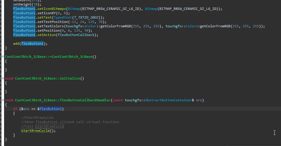

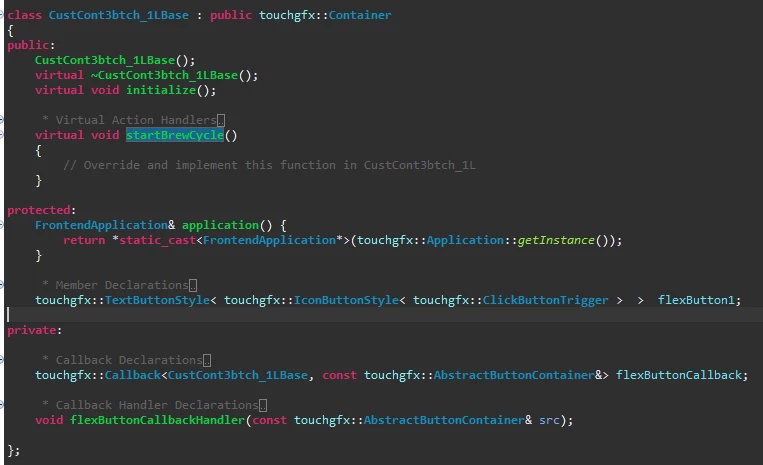

How do I trigger a new virtual function when a touch button (flexButton) is released instead of pressed?
I'm fairly new to TouchGFX as well as C++ inheritance so trying to understand how to implement a custom virtual function when a key is released. I see when I create an interaction in touchGFX so when a key is pressed it calls a virtual function...
_legacyfs_online_stmicro_images_0693W00000blHmxQAE.pngWhich creates the following in the base class of the custom container...
_legacyfs_online_stmicro_images_0693W00000blHiSQAU.pngI understand how to override the startBrewCycle() virtual function in the non-base cpp file which is called with the pressed even in the callback below...
_legacyfs_online_stmicro_images_0693W00000blHoPQAU.pngHow can I implement another virtual function stopBrewCycle() when the same button is released?

I found my old example, just modify it for flexbutton, maybe this helps. The flexButton click handler is bit more tricky than other button types. Here in the example flexbutton has just Box with border- element.
One way is to create ClickListener to the FlexButton, so set it on at Mixins of your flexButton:

Please note that this works only with flexButton that has only Box with border. If you have some other elements, check in screen1base.hpp the inheritance structure of your flexButton
/* Screen1ViewBase.hpp
 * Member Declarations
// HERE !!:
 touchgfx::ClickListener< touchgfx::BoxWithBorderButtonStyle< touchgfx::TouchButtonTrigger > > flexButton1;
Only BoxWithBorder:
All 4 elements:
 touchgfx::ClickListener< touchgfx::IconButtonStyle< touchgfx::TextButtonStyle< touchgfx::ImageButtonStyle< touchgfx::BoxWithBorderButtonStyle< touchgfx::TouchButtonTrigger > > > > > flexButton1;
This case you must replace the callback and clickHandler function parameters to match your flexbutton elements at in Screen1.cpp and .hpp !
Example is tested with Simulator and F769IDisco evalkit. BTW what hardware you are using ?
