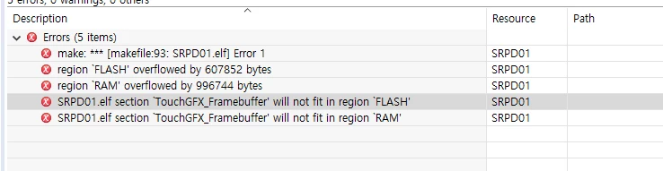

If you set TouchGFX in the stm32f429IG setting, an error appears for the memory below. External SDRAM is in use, FMC setting is done.
We drew a background from TouchGFX and loaded that background, which resulted in the above problem in compilation.
I don't know which setting is wrong.
If there is a problem with SDRAM settings, does this error appear?
Who can help you solve this error?
Best answer by Alexandre RENOUX
What IDE are you using ?
I believe you haven't modified your linker file to tell the compiler to link the framebuffer to the external RAM. Have a look at the F429-DISCO Application Template available on TouchGFX Designer for reference.

Thank you for your advice.
As you said, the above problem is being used well now because of the linker disconnected.
