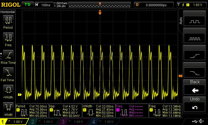

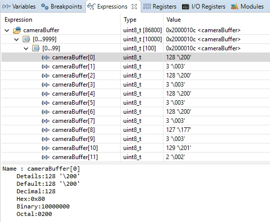

I have been able to get data from the OV7670 camera and I can see values in the "cameraBuffer[]" array.
I think the issue was the OV7670 needs an input clock (10-48MHz). I am giving it a 13MHz input clock from stm32 Timer5, channel 3 with frequency of 20 (20MHz clock = 80MHzTimerInputClock / 1 prescaler / 2 period / 2 pulse(50%duty cycle)
The actual measured from Oscilloscope is about 13MHz.
I am seeing data in the expression window like the attached image.
