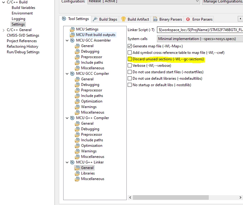

How do I create a section in QSPI and put the array for the DAC there?
  • July 6, 2021
  • 3 replies
  • 1529 views
Greetings.
I have a microcontroller and QSPI flash. Everything works fine with TouchGFX. The pictures are stored in ExtFlashSection on the flash.
I need to store 3 large arrays for DAC. Tried adding to "STM32F746BGTX_FLASH.ld" except
ExtFlashSection :
		*(ExtFlashSection ExtFlashSection.*)
		*(.gnu.linkonce.r.*)
 . = ALIGN(0x4);
	} >QUADSPI
section like this
MusicFlashSection :
		*(MusicFlashSection MusicFlashSection.*)
 . = ALIGN(0x4);
	} >QUADSPI
also added in "Middlewares\ST\touchgfx\framework\include\touchgfx\hal\Config.hpp"
#define LOCATION_MUSICFLASH_PRAGMA LOCATION_PRAGMA("MusicFlashSection")
#define LOCATION_MUSICFLASH_ATTRIBUTE LOCATION_ATTRIBUTE("MusicFlashSection")
Build Analyzer did not show a new section.
Then I found an example C:\Users\User\STM32Cube\Repository\STM32Cube_FW_F7_V1.8.0\Projects\STM32746G-Discovery\Applications\QSPI\QSPI_perfs
and copied in my "STM32F746BGTX_FLASH.ld"
.textqspi :
 . = ALIGN(4);
 _qspi_start = .; /* create a global symbol at qspi start */
 *(.textqspi) /* .textqspi sections */
 *(.textqspi*) /* .textqspi* sections */
 . = ALIGN(4);
 _qspi_end = .; /* define a global symbols at end of textqspi */
 } >QSPI AT> FLASH
and
.textqspi : { *(.textqspi) } >QSPI
Added my arrays similar to the example, but Build Analyzer still didn't show a new section.
Can someone please tell me what I've missed? The analogy just didn't work and I don't know where or how to look for a solution.
 I programmed in CubeIDE.

 __attribute__((section(".textqspi")))

Yes of course I did it in a similar way to the example.
#ifndef _WAVE1_H
#define _WAVE1_H
#define NUM_ELEMENTS_1 13223
#ifndef IMG_NO_DATA
#if defined ( __ICCARM__ )
#pragma location = ".voiceqspi"
#else
__attribute__((section(".voiceqspi")))
#endif
const unsigned short Wave_1[13223] = {
2035, 2034, 2033, 2032, 2030, 2030, 2029, 2028, 2028, 2026,
2053, 2035, 2060};
#else
extern const unsigned char Wave_1[];
#endif
#endif

July 8, 2021
