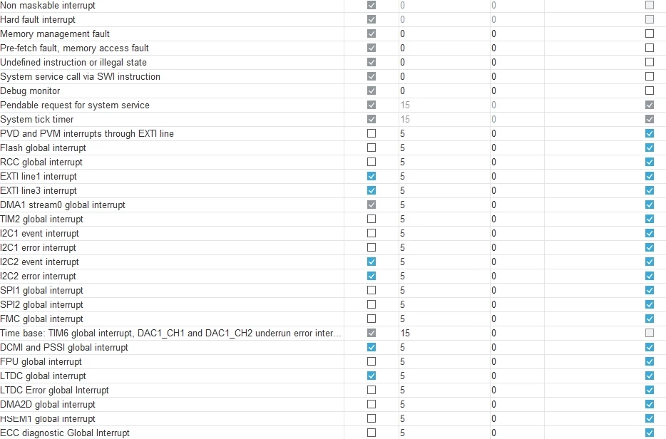

I'm using an STM32H7A3IITxQ and trying to get an image (JPEG, 320x240) from a camera via DCMI, decompress it and display it on a screen via LTDC.
It currently seems like I'm getting a valid JPEG picture from the camera, as there is "Start of Image" and "End of Image" in the buffer and about 4kBytes of data. (https://de.wikipedia.org/wiki/JPEG_File_Interchange_Format)
I'm also able to display data on the screen via LTDC. (Set up TouchGFX and FreeRTOS)
My current problem is the decompression of the JPEG with LibJPEG. I copied the code from an example and modified it, since my JPEG is in a buffer and not a file on a SD-card.

After jpeg_start_decompress has finished cinfo.output_height is 240 and cinfo.output_width is 320, as I expect them to be. The if-statement after that is always false, as the buffer is large enough for the image.
The problem is that the processor gets into an infinite loop a short while after executing jpeg_start_decompress (jpeg_startDecode does not return in any case, but the time is kinda "random"). The infinite loop comes from this assert:
//port.c
configASSERT( ucCurrentPriority >= ucMaxSysCallPriority );
//ucCurrentPriority is 144 here and ucMaxSysCallPriority is 244.
//FreeRTOSConfig.h
#define configASSERT( x ) if ((x) == 0) {taskDISABLE_INTERRUPTS(); for( ;; );}
The interrupt triggering this was the LTDC global interrupt. LTDC LineEvent to be exact.
As there is a description in the source (port.c) on why the assert can fail, I checked my NVIC.

I really don't see any problem with the interrupt priorities here.
Does someone has an idea what went wrong here?

For everyone who has the same problem:
I switched to the hardware JPEG Codec, since my processor has one and it is working fine with the same setup.
I haven't solved the problem with LibJPEG and I will not.
