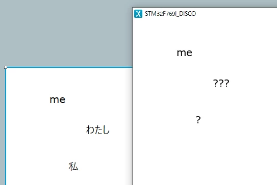

How can I use Japanese?
Thank you for helping.
How can I use English and Japanese?
Can you speak Japanese even if you run the simulator? The characters are garbled.
Romain DIELEMAN
Romain DIELEMANBest answer
March 31, 2021
The issue you faced is due to the font you selected. You need to use a font that properly handles Japanese. I used for example IPA which is enclosed in the project attached.

Hello Ebun.1,
Using Japanese and English should be pretty straight forward. Could you enclose your project so that I can have a quick look ?
/Alexandre
Ebun.1
Ebun.1Author
Senior
March 31, 2021
Hi Alexandre RENOUX
Attach the compressed file of the project.
( made by TouchGFX Ver4.16.1 )​
Thank you.

Hi Romain Dieleman
Thank you for adding it to the project.
Where should I touch? I understood about.

I was able to understand where to modify the display in Japanese.
No problem.
Thank you very much.
