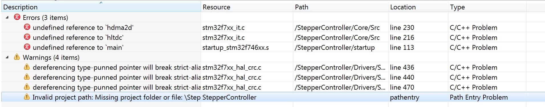

Unfortunately I am continuing to be unable to build my project. When I build, I get the following errors:
I get these same errors when I create a simple TouchGFX GUI rather than import my old GUI.
I am also going to attach a zip of my project in case it helps. Would it be best for me to address these build errors in a new topic?
