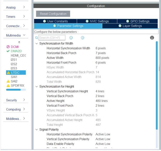

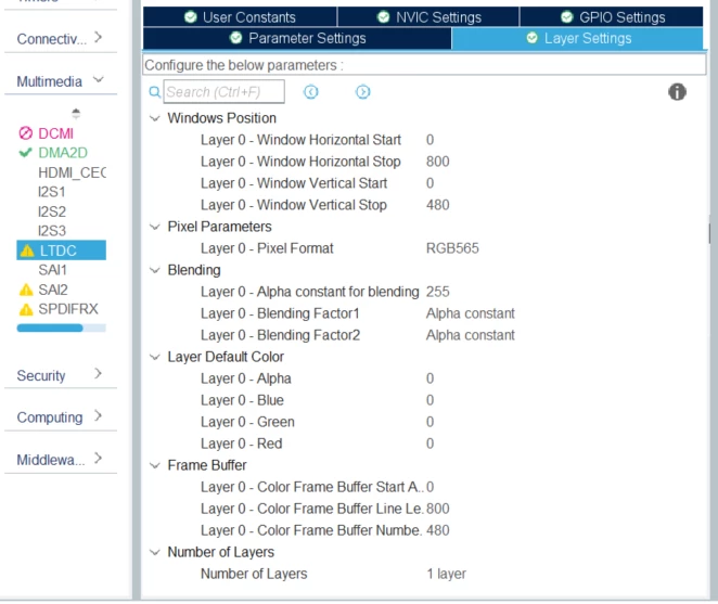

How can I set extra RAM and Flash for TFT LCD display project?
I'm working on a project where I should display some parameters on display. The display resolution is 800 x 480. I followed some tutorials to how to set touchGFX on MXCube and then imported on Cube Ide the project. The problem is that when I compile the project it keeps me saying that the both RAM and Flash overflows, as you can see in listing below:
c:\st\stm32cubeide_1.12.0\stm32cubeide\plugins\com.st.stm32cube.ide.mcu.externaltools.gnu-tools-for-stm32.10.3-2021.10.win32_1.0.200.202301161003\tools\arm-none-eabi\bin\ld.exe: test1.elf section `TouchGFX_Framebuffer' will not fit in region `RAM'
c:\st\stm32cubeide_1.12.0\stm32cubeide\plugins\com.st.stm32cube.ide.mcu.externaltools.gnu-tools-for-stm32.10.3-2021.10.win32_1.0.200.202301161003\tools\arm-none-eabi\bin\ld.exe: test1.elf section `TouchGFX_Framebuffer' will not fit in region `FLASH'
c:\st\stm32cubeide_1.12.0\stm32cubeide\plugins\com.st.stm32cube.ide.mcu.externaltools.gnu-tools-for-stm32.10.3-2021.10.win32_1.0.200.202301161003\tools\arm-none-eabi\bin\ld.exe: region `RAM' overflowed by 447656 bytes
c:\st\stm32cubeide_1.12.0\stm32cubeide\plugins\com.st.stm32cube.ide.mcu.externaltools.gnu-tools-for-stm32.10.3-2021.10.win32_1.0.200.202301161003\tools\arm-none-eabi\bin\ld.exe: region `FLASH' overflowed by 595640 bytes
collect2.exe: error: ld returned 1 exit status
make: *** [makefile:90: test1.elf] Error 1

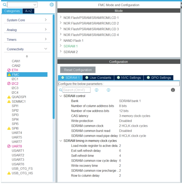

I set the SDRAM and DMA2D, but is not working. I don't plan to use freertos.
Here are some screenshot of the settings of the project:
0693W00000bhTkgQAE.png0693W00000bhTl5QAE.png0693W00000bhTlFQAU.png0693W00000bhTltQAE.pngThe MCU that I'm using is STM32F746ZG.
The display that I'm using is the MIKROE-3620.
What can I do to resolve the overflowing problem?

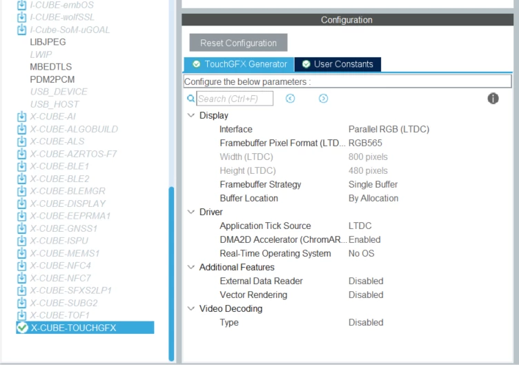

Apr 4, 2023 5:38 PM UTC
Hello
Set the Buffer location to 'By address' insted of 'By allocation'. And then set address where you want to place the frambuffer to the Start address (typically SDRAM1 starts from 0xC0000000).
Maybe this touchGFX documentation is worth reading: Display with framebuffer in external RAM
Also other 'Board bring up' chapters might be helpful.

Apr 4, 2023 7:09 PM UTC
Thanks a lot. It has definetly helped to set the buffer location "by address". Now when I compile, it does show no more errors.
I already read the TouchGFX docuentation and followed their step to set up SDRAM and DMA2D, but I was stuck at the overflowing problem.

MIKROE ??? Have you real SDRAM chips on your board. SDRAM isnt somthing to turn on...
