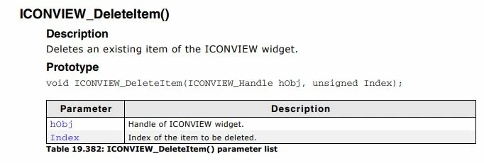

Hello @kadir üstün​ ,
You can use ICONVIEW_DeleteItem() which allow deletes an existing item of the ICONVIEW widget.
Best Regards,
Imen

Thank you for answered, I tried this function but it did not anything.
