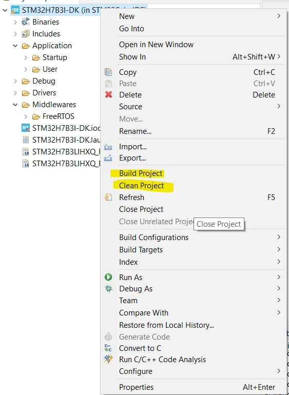

How can I create a TouchGFX Project with the STM32H7B3I-DK and write usercode with CubeIDE?
I have start with TouchGFX, select the demo board and generate the code. Simulator and download works.
But now, when I want open the project with CubeIDE, the first is, the project is completly empty. Then when I start a new project with the existing IOC file, then CubeIDE generate a seperate folder with other files, but there are not the auto generates files from TouchGFX visible.
What is wrong? Please write me step by step how can I start my own project with STM32H7B3I-DK.

Nothing is missing :grinning_face_with_sweat:
I opened your project you shared, and I find all the files.

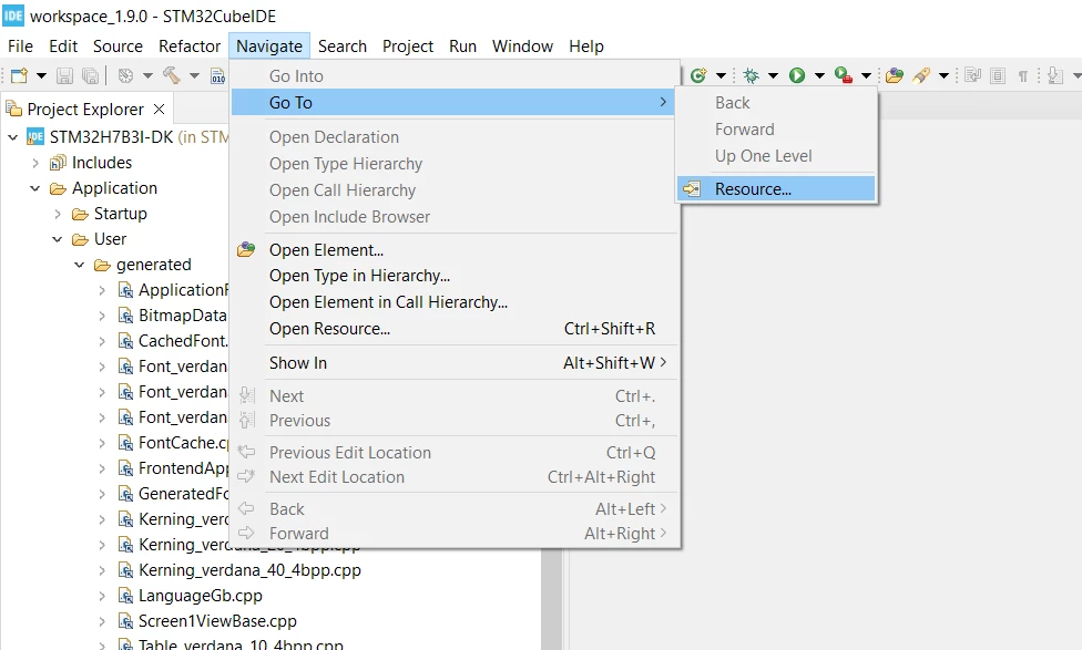

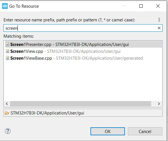

0693W00000UnENWQA3.pngI opened TouchGFX Designer, I regenerate code from there. Then in STM32CubeIDE, I cleaned the project (right click, "Clean Project"), then I built it (right click, Build Project"). No errors, no warning during compilation. So the project is working.
If you can't find a specific resource file in the tree, try to do a global search by its name like this :
/Osman

Osman SOYKURT
Oct 3, 2022 11:24 AM UTC
Hello again MMüll.6,
I do the 2nd way always, but I think you're missing one step;
- Start with TouchGFX:
  • Simulator works directly
  • Download with TouchGFX works
  • GENERATE CODE WITH TOUCHGFX DESIGNER (press F4)

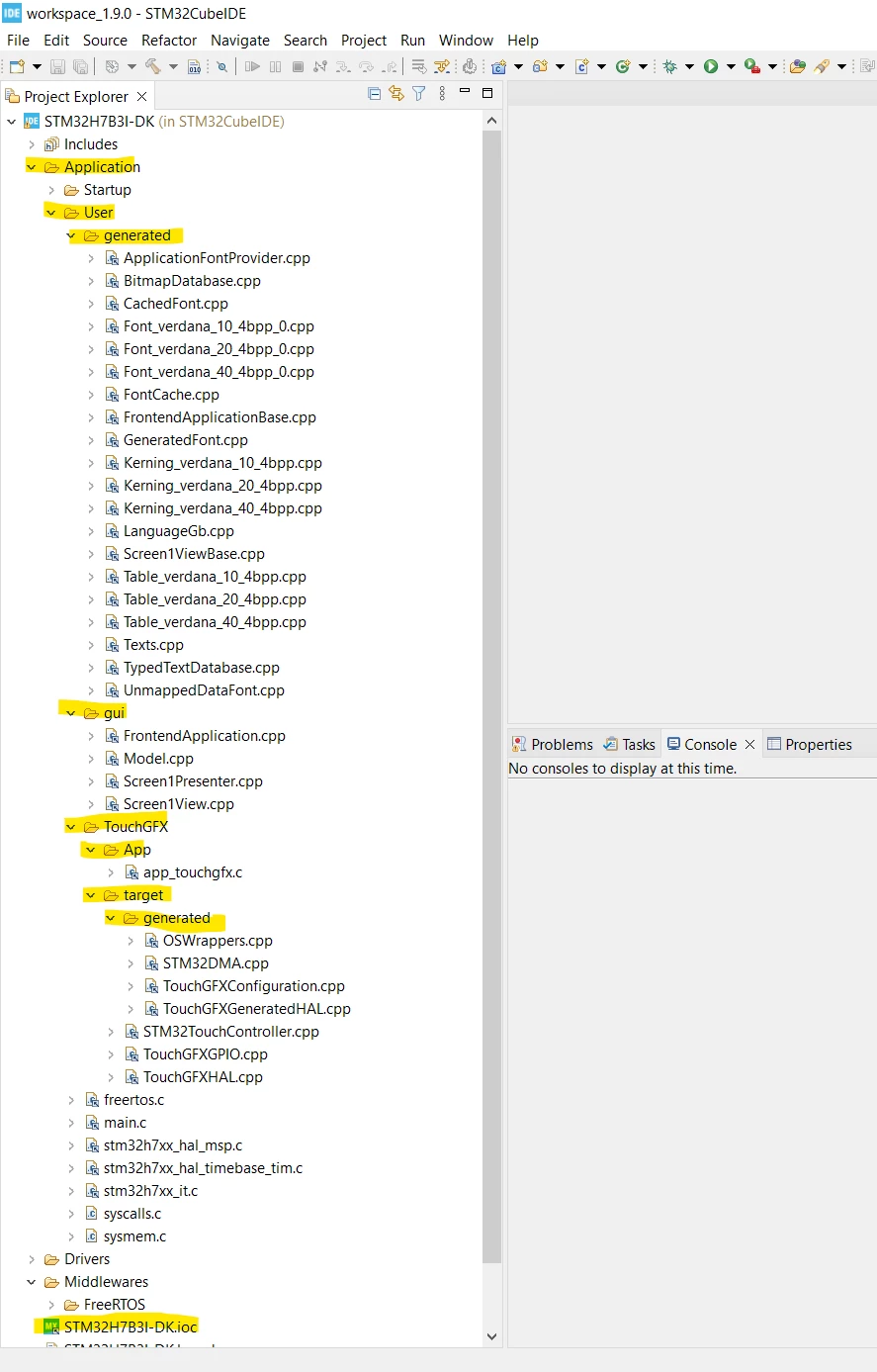

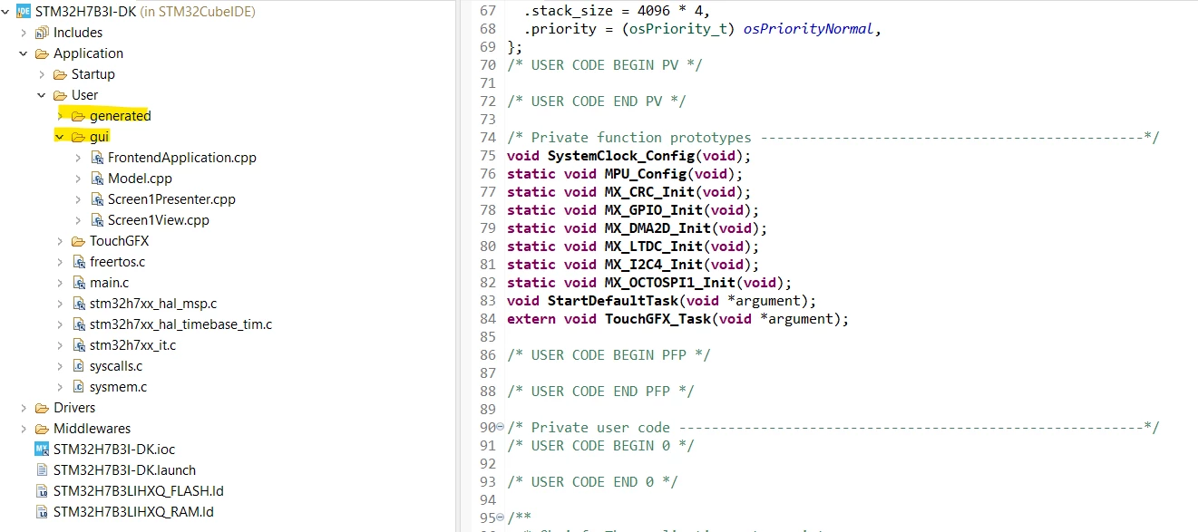

  • Open CubeIDE : it should work.0693W00000UnDLPQA3.png
  • All the TouchGFX generated files & user code are visible 0693W00000UnDN1QAN.png
Can you try that ?
/Osman

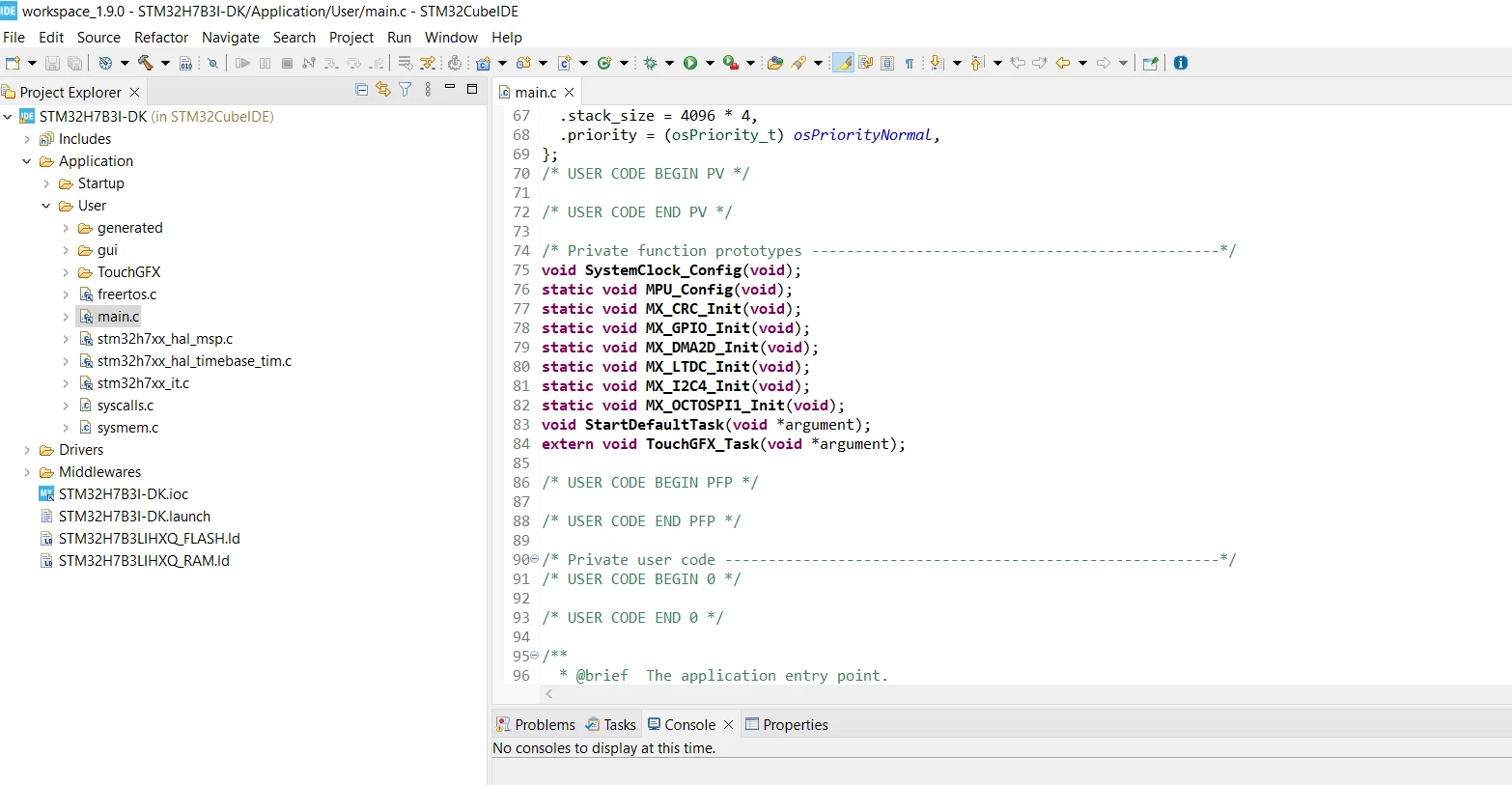

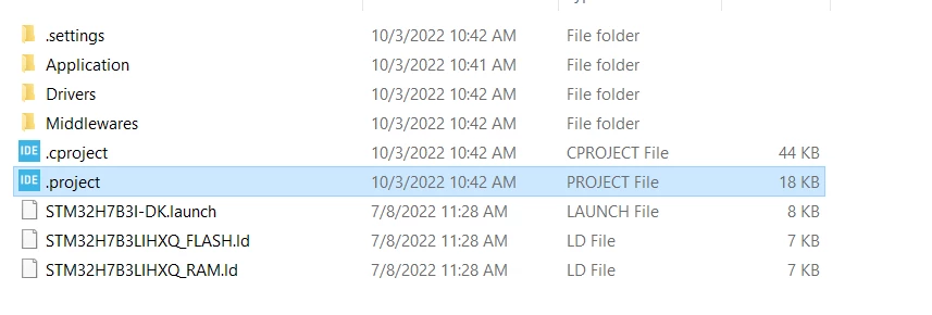

I have generate the code with TouchGFX designer:
MMüll.6
MMüll.6Author
Oct 3, 2022 3:54 PM UTC
Thank you very much!
Yes, now all works:
  • Debug with CubeIDE
  • TouchGFX Simulator
  • TouchGFX Download
I'm very happy!
/Markus
