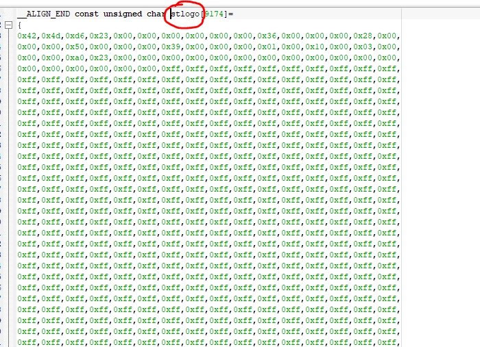

how can i convert image.png color with BmpCvt.exe to an buffer 8 bit like stlogo.h and plot it in stm32f796i-discovery with a function BSP_LCD_DrawBitmap(uint32_t Xpos, uint32_t Ypos, uint8_t *pbmp) ??
i convert an image RGB to a buffer 8 bits and plot it with a function BSP_LCD_DrawBitmap(), but not work correctly like logo image.
please any idea ?

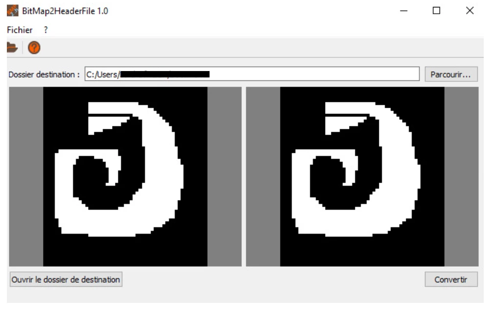

After search on net too much time, i found a software that
@sebastien Dumoulin​ made.
https://www.electro-info.ovh/bitmap2headerfile
He or she did really well program, but i have some problems with that.

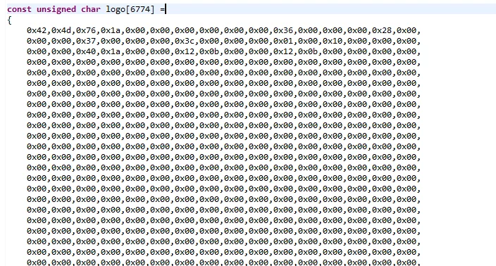

Software export (in pictures.h):
stm32f746g-disco BSP_LCD_DrawBitmap() function main.c:
#include "pictures.h"
BSP_SDRAM_Init(); /* Initializes the SDRAM device */
  __HAL_RCC_CRC_CLK_ENABLE(); /* Enable the CRC Module */
  BSP_TS_Init(480, 272);
  BSP_LCD_Init();
  BSP_LCD_LayerDefaultInit(0, LCD_FB_START_ADDRESS);
  BSP_LCD_DisplayOn();
  BSP_LCD_SelectLayer(0);
  BSP_LCD_Clear(LCD_COLOR_RED);
  BSP_LCD_DisplayStringAt(0, 100, (uint8_t *)"Hello!", CENTER_MODE);
  HAL_Delay(700);
  BSP_LCD_DrawBitmap((BSP_LCD_GetXSize() - 80) / 2, (BSP_LCD_GetYSize() - 80) / 2, (uint8_t *)logo);
  HAL_Delay(500);
Software with png:
0693W00000QM5eiQAD.pngbut after upload to stm32f746g-disco showing on lcd this:
0693W00000QM4rWQAT.jpgProblems:
1)The picture started to drawing on half of the picture.
2)The picture slipped a little.
Do anyone have any opinion how to fix these ?
Software owner said that this program open source software. Could someone say how to change somethings in The software ?
Could someone recommend a program like this software that png to .h file with this format correctly ?

Making the .H files contain hex arrays is a trivial exercise. One can do it for any file.
The problem is with the underlying format of the data, and how you process it. The .BMP files are a simple bitmap/raster format.
Things like .GIF, .JPG and .PNG are more complicated involving encoding and compression methods that need to be managed to unpack the data into lines/rasters and painted into the frame buffer.
The shift and diagonal line suggests you've got the line length off-byte-one, or perhaps the x and y dimensions switched.
