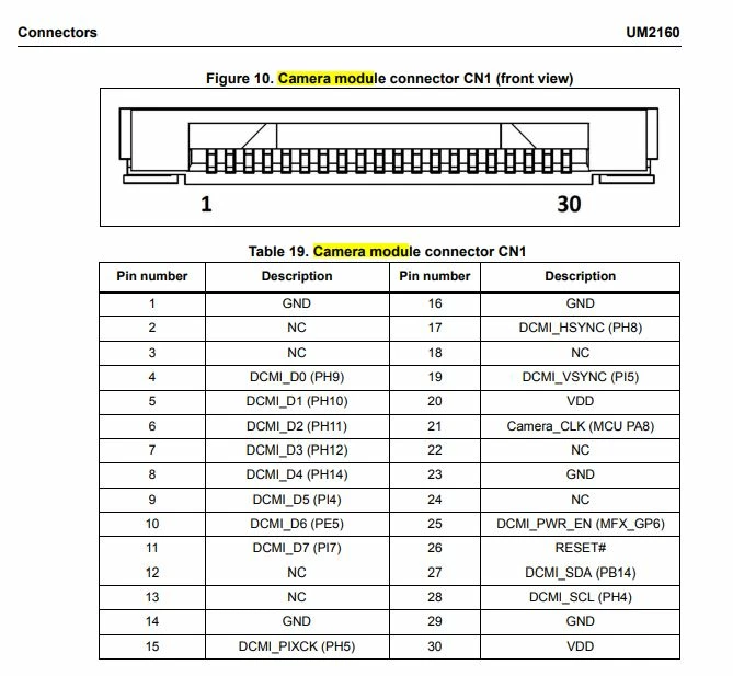

Hola, estoy haciendo un proyecto usando la placa STM32L496G-DICOVERY para capturara fotos y video, quiero usar la cámara OV2640 pero no sé si esa cámara es compatible con esa placa ya que la placa tiene conector plug and play,

You can use OV2640 CMOS sensor with L4 board, but make sure that your camera module embedded the OV2640 is compatible with the camera connector CN1 of 32L496GDISCOVERY.
I advise you to refer to the Table 19. Camera module connector CN1, in the UM2160 and check the pins and configuration.

Thanks for your resoonse, I read the datasheet but I bought a OV2640 with FFC conector but it turns out that it has 24 pins and the conector of the STM32L496G_DISCOVERY has 30, so can you recomend me other mudule or a solution for that.

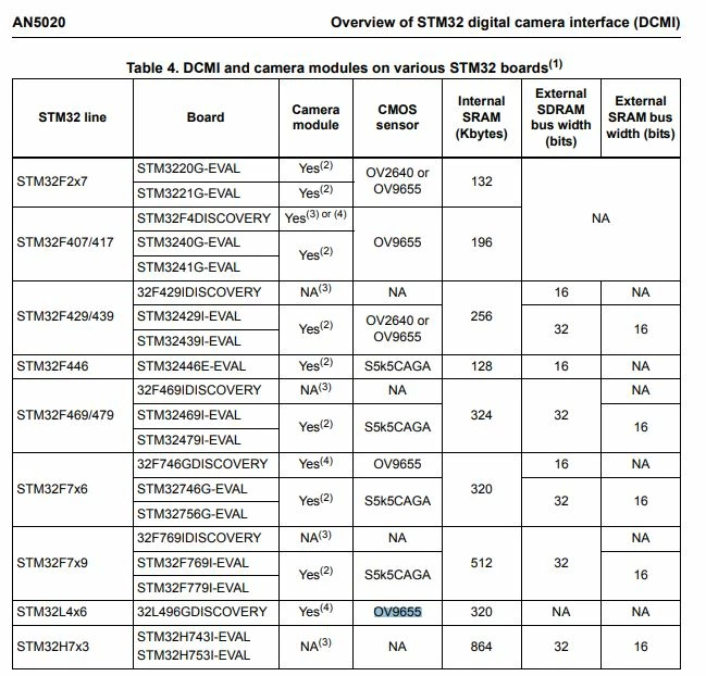

You can use the OV9655 CMOS sensor with the STM32F4DISCAM camera module.
I advise you to refer to the table 4 (and note 4) on the AN5020 - page 21.
