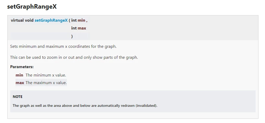

Histogram X scale cannot be set to display only 1 bar
Scaling down an histogram graph to display only one bar triggers a "(min != max)" error.
I need to display from 1 to 16 bars on my histogram.
I use the setGraphRangeX(int min, int max) function for this.
However, when I get down to 1 bar with setGraphRangeX(0, 0) I get an error during execution.
This error is clear enough, but I think this limitation should not be there.
Is there anyway to get around it?

Hello @Community member​,
setGraphRangeX(0, 0) does mean that you wanna display data between xmin = 0 and xmax = 0 :
So it means that you are basically showing nothing. If you wanna display only the first bar, I guess it should be setGraphRangeX(0, 1) instead.
For me, this limitation makes good sense, could you maybe elaborate why it doesn't look right for you and explain what we should implement instead ?

Hi Yoann,
Thanks for the answer.
Yes, I would like to display xmin = 0 and xmax = 0 to get only one bar.
This would show only the first data point (data at position 0).
setGraphRangeX(0, 2) => displays 3 bars
setGraphRangeX(0, 1) => displays 2 bars
setGraphRangeX(0, 0) => triggers an error, so we cannot display only 1 data point.
The limitation should be xmin > xmax instead of xmin != xmax
Franck.

I think there is also a setGraphRangeX() method with float xmin and xmax parameters.
What if you try to use setGraphRangeX(0, 0.5) or something similar ?
I understand your problem and will discuss it with my colleagues, but that could be a work-around in the meantime.

Mar 28, 2023 12:13 PM UTC
Yes, nice trick!
It does work using float parameters.
I used setGraphRangeX(0.0f, 0.0001f + Range) instead of 0.5f + Range as the 0.5f adds some margin on the right when the range is set to the maximum.
