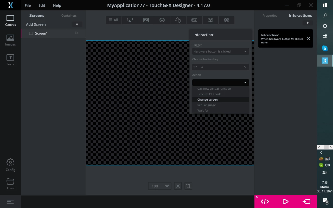

Hi.I want to swap pages in touch gfx with a pushbutton. I know how to for example toggle a LED on-screen but need to change the screen. how can I do that? I am new in touch gfx so I would appreciate your help

ps:I need to know it step ny step because of my limited knowlege.
Best answer by MM..1
As first without knowledge stop plan use C++. And change screen learn here
0693W00000GZQdwQAH.pnggenerate code run in simulator and press "a" key or other choiced, then check code...
