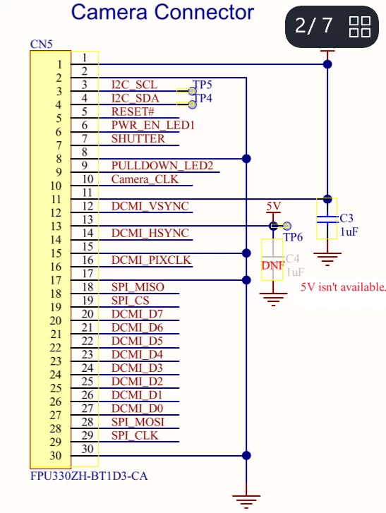

Hi I planing to buy B-CAMS-OMV module and i want to know if this module can be compatible with stm32l496G-Discovery board.

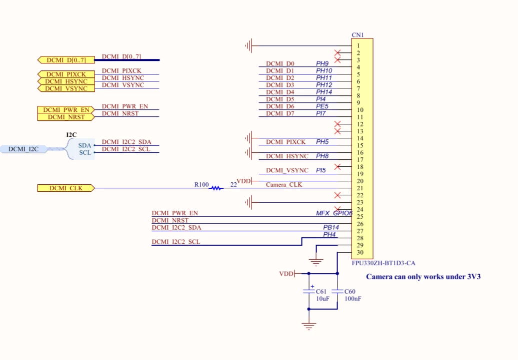

FTila.1
FTila.1Author
February 17, 2022
Hi @Peter BENSCH​
Thank you for answering my question, in the datasheet i see that the configuration of the pins of the module y 32L496GDISCONVERY is diferent.
0693W00000KZaYiQAL.png0693W00000KZaZCQA1.pngthe first picture is the zif conector of the camera module and the secund is the zif conector of 32L496GDISCOVERY.
Peter BENSCH
Peter BENSCHBest answer
February 18, 2022
Well spotted, but your observation also applies to the 32L4R9IDISCOVERY, whose pin assignment of the camera connector is identical to the 32L496GDISCONVERY.
If you look closely, you will notice that the pins are crossed: 1-30, 2-29, 3-28 etc. This is because the connectors are horizontally rotated by 180° on the boards and the ribbon cable realises exactly this crossing.
