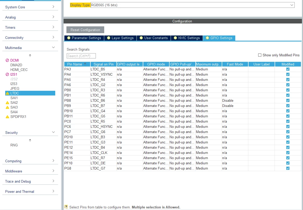

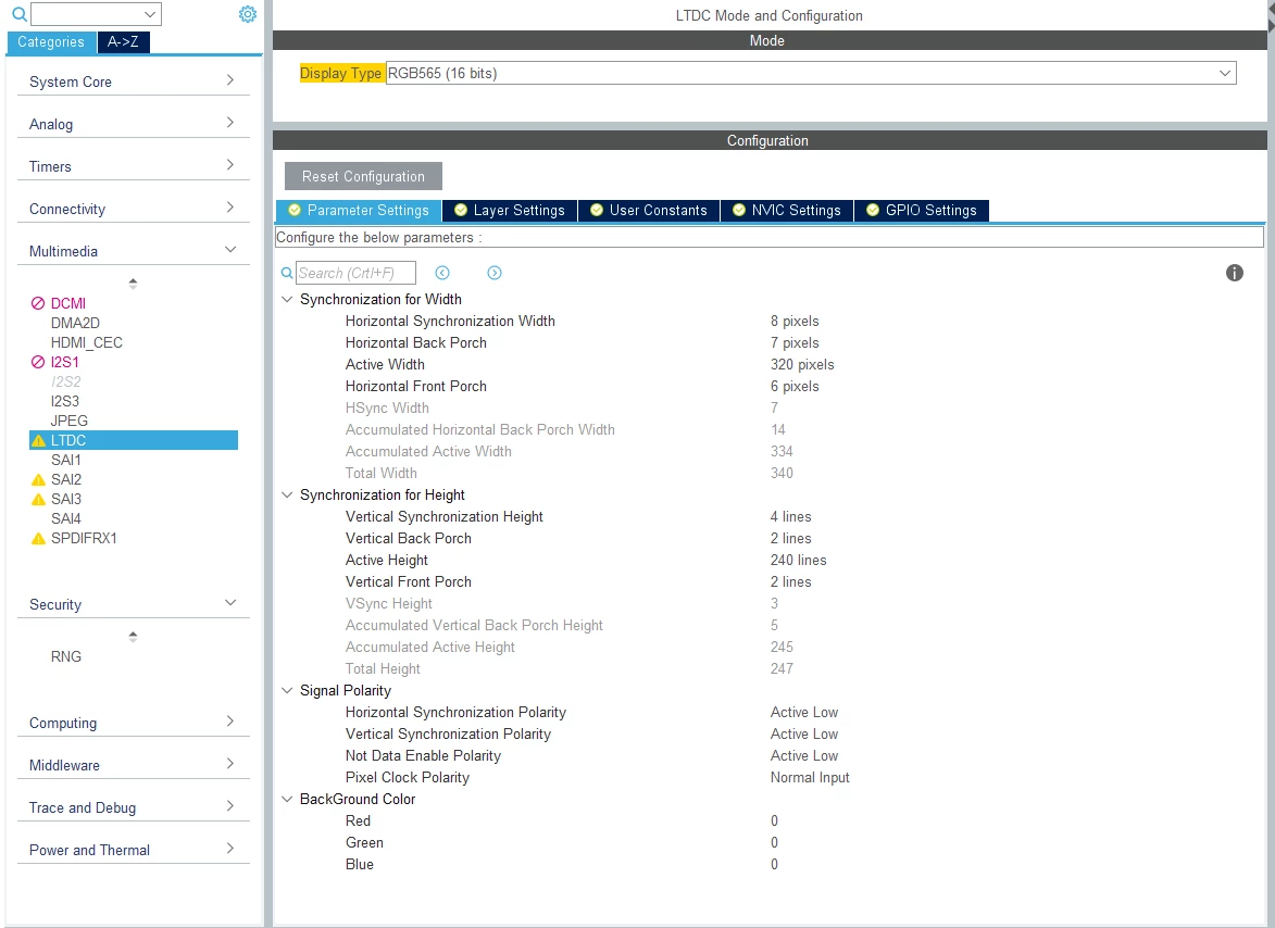

Hi I'm using STM32H743 nucleo 144 with ltdc configurations and I'm using internal clock. The program stacks in ltdc init() in lines that initialize GCR register. What can be the problem? Below are some configuration of ltdc
