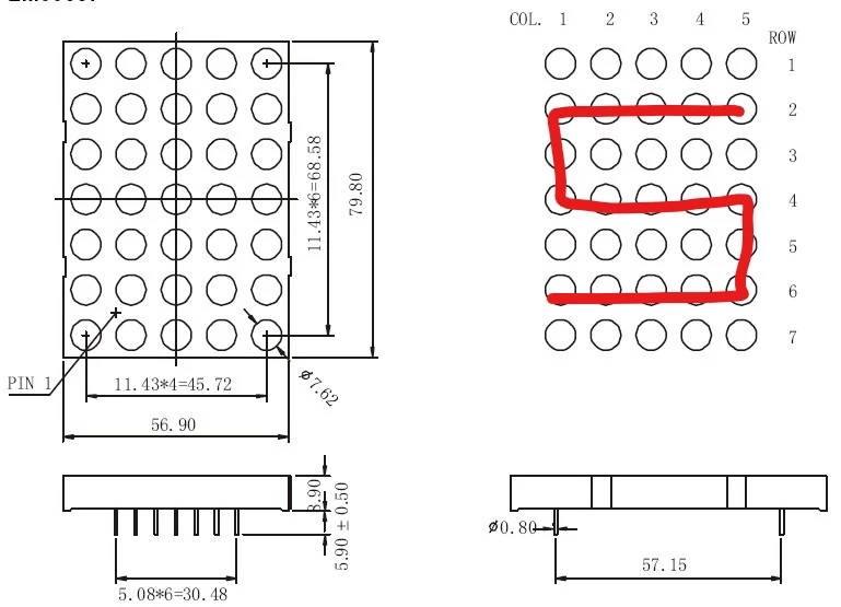

hi I'm using avago 5*7 led display. I need to use user defined code to display my letters please can anyone let me know how to use it?

I need to skip the upper row and lower row and print the characters.

    waclawek.jan
    December 15, 2021
    Show us what do you have so far - both hardware and software.
    What do you mean by "skip the upper row and lower row"?

    In addition to what @Community member​ said, have you looked on the Avago site for application notes, examples etc?
    Have you searched for other examples?
    Note that Avago is now Broadcom: https://www.broadcom.com/products/leds-and-displays/smart-alphanumeric-displays/parallel-interface/hdsp-2533

    0693W00000HomtMQAR.jpgHi waclawek and andrew please see attached pdf and actual i need to print as picture show im following as per pdf but udc(user defined code) address start with 80 upto 8f in 1st address i can store remaining is not working. im communicating display with parallel bus using stm32 controller.

    Thank you for suggestions @Andrew Neil​  and @Community member​. I got the issue it was some address problem I Solved it.
