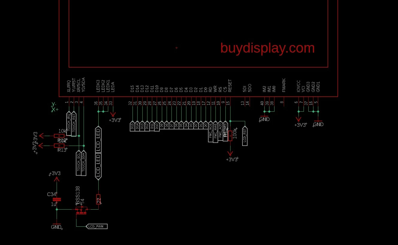

Hi, I have a problem with communication between STM32F76ZGT and tft LCD using FMC.
 All connections are correct but only the backlight is turned on. On another processor, the following code works fine. I attach the entire project and the display connection diagram. Thank you in advance for your help.

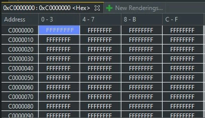

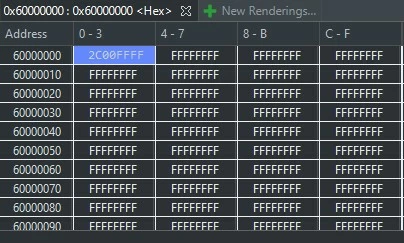

Sep 2, 2022 10:11 AM UTC
0693W00000SuNSCQA3.jpg0693W00000SuNS7QAN.jpgWhen remap is the default so base address is 0x6000000, it only wrote data to the first memory group when I called HAL_EnableFMCMemorySwapping ();
and changed the address to 0xC0000000 Nothing is typed into the cells. I have no idea why that is
waclawek.jan
Sep 2, 2022 1:10 PM UTC
Read out and check content of relevant register, SYSCFG_MEMRMP.
Are you sure the connected LCD controller works as a static memory, i.e. that you can simply read back what you've written to it?
