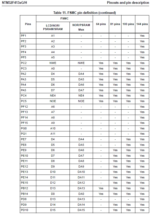

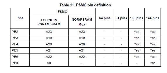

Hi Berendi,
Thanks for your detailed explanation. I will connect as per your suggestion. Can you please help me to know about the RD and WR pin connection which pin should i use for it? 0690X00000DYeRqQAL.png0690X00000DYeRWQA1.png
berendi
Principal
March 4, 2020
I think that FSMC_NOE is RD, and FSMC_NWE is WR, but you should rather check it yourself using the display datasheet and the FSMC chapter in the reference manual.
