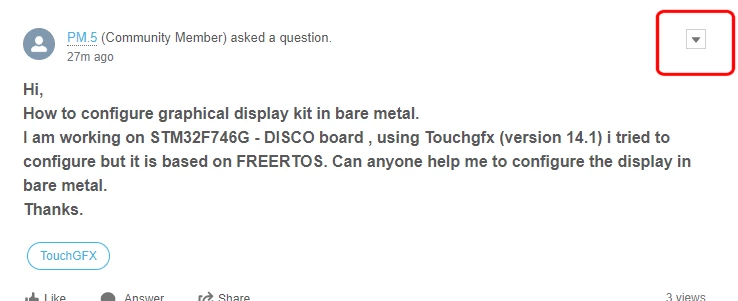

Hi, How to configure graphical display kit in bare metal. I am working on STM32F746G - DISCO board , using Touchgfx (version 14.1) i tried to configure but it is based on FREERTOS. Can anyone help me to configure the display in bare metal. Thanks.

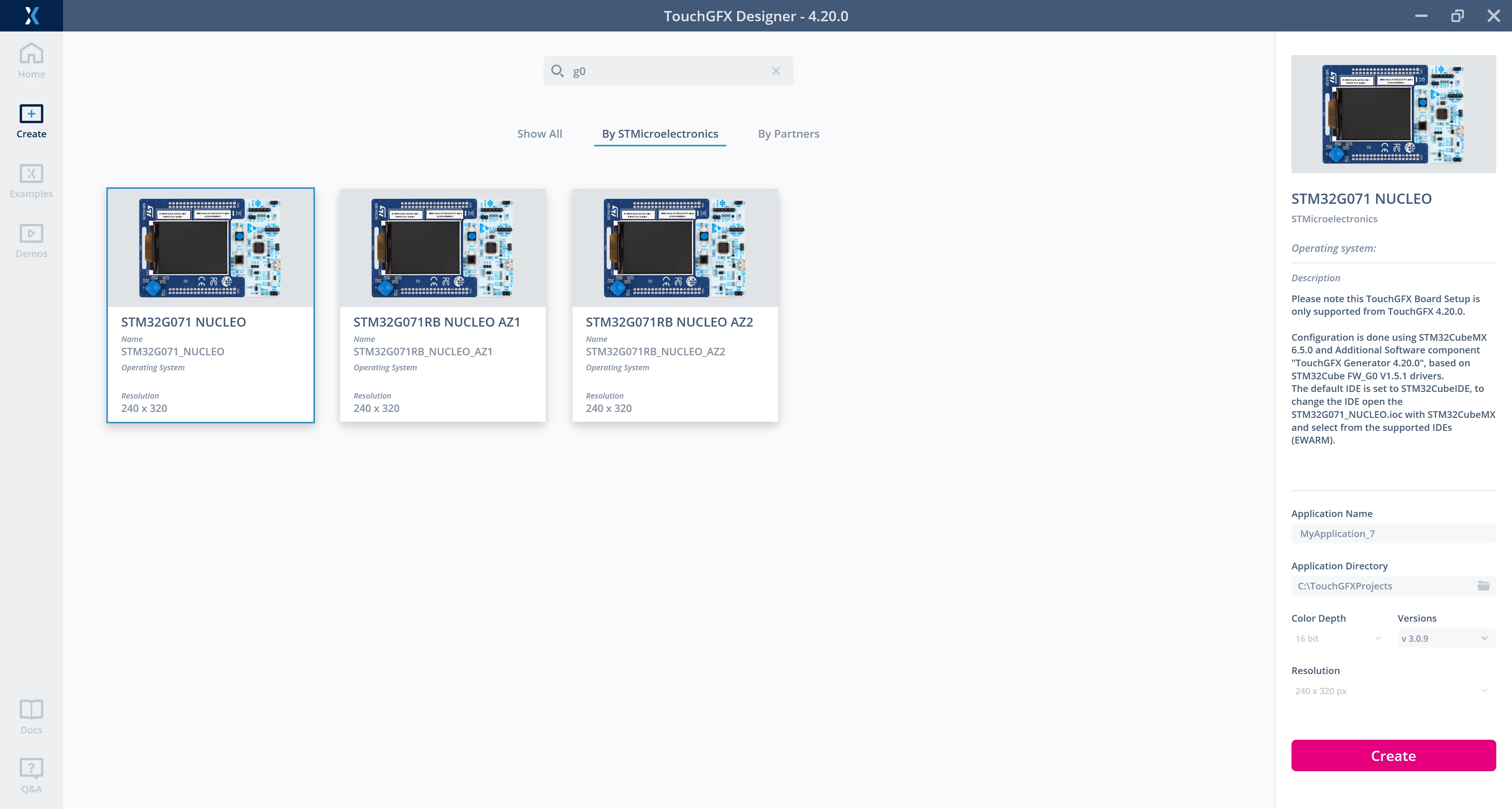

To configure bare metal on your board, I'd recommend you to take a look a the STM32G0 TouchGFX Board Setup available in TouchGFXDesigner. It already implements that.

I have gonna through the stm32G0 code , I tried to implement the same in stm32f746g board. But the issue remained the same i.e., code is getting hanged at this function given below.
void OSWrappers::takeFrameBufferSemaphore()
  while(fb_sem); // code is getting hanged at this line//
  fb_sem = 1;
