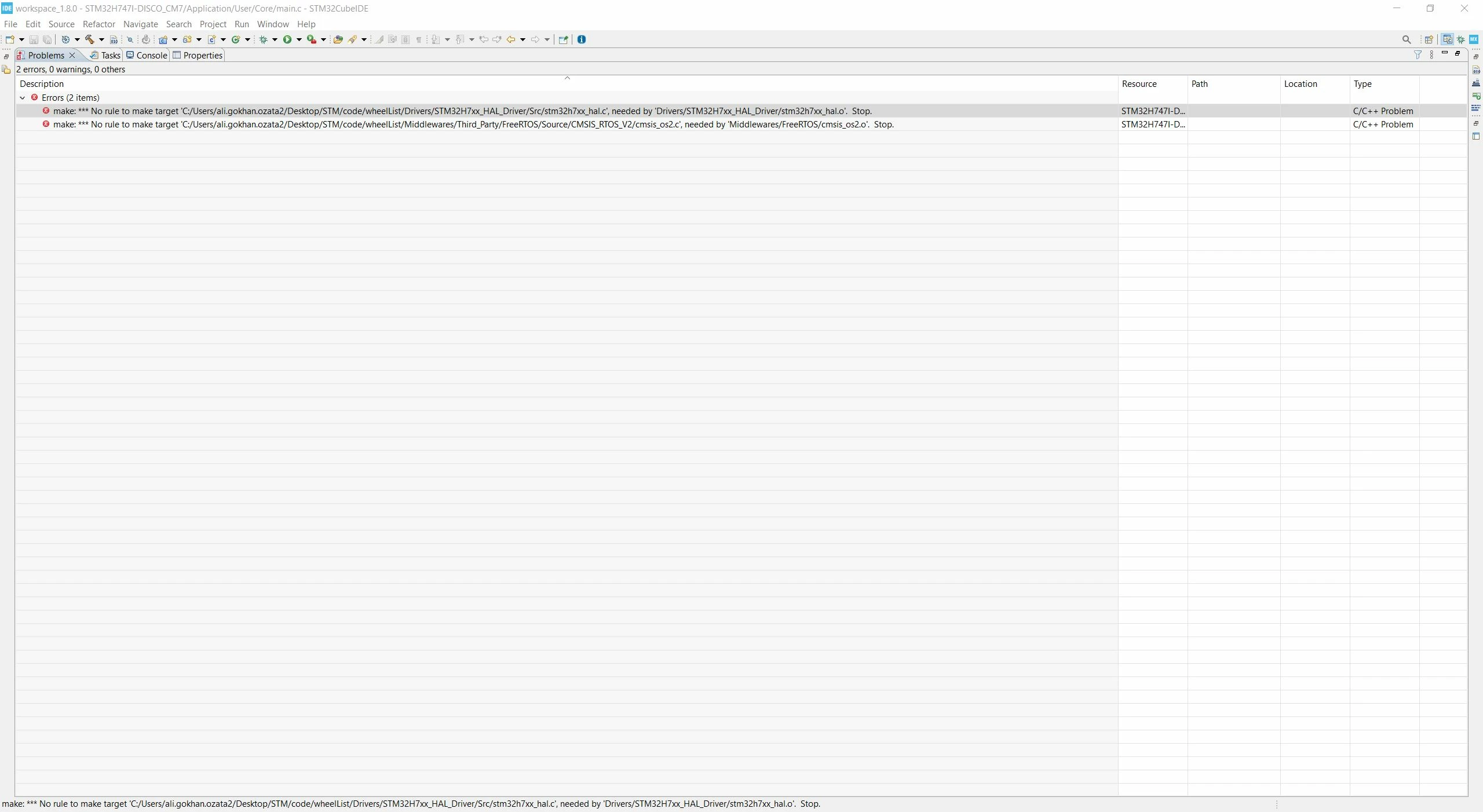

Hi everyone, I created a project via Touch GFX. I write calculations codes and others things with CubeIDE. I can't open the project on another computer. It gives error. It want file root of creater computer. I'm begineer in STM32 :)

How you open project in new PC???
gokhanozata
Apr 14, 2022 2:10 PM UTC

Okay, i know use eclipse projects. I think I didn't explain my question well.
When i build or debug the project(created by creator pc) on CubeIDE, it gives target file error on another pc.
I created project on Touch GFX and wrote the code on CubeIDE. And I build and run target to STM32H747I. It perfectly run.
But I sended project to my friend. He opens the project on his pc and builds. But CubeIDE gives error.
