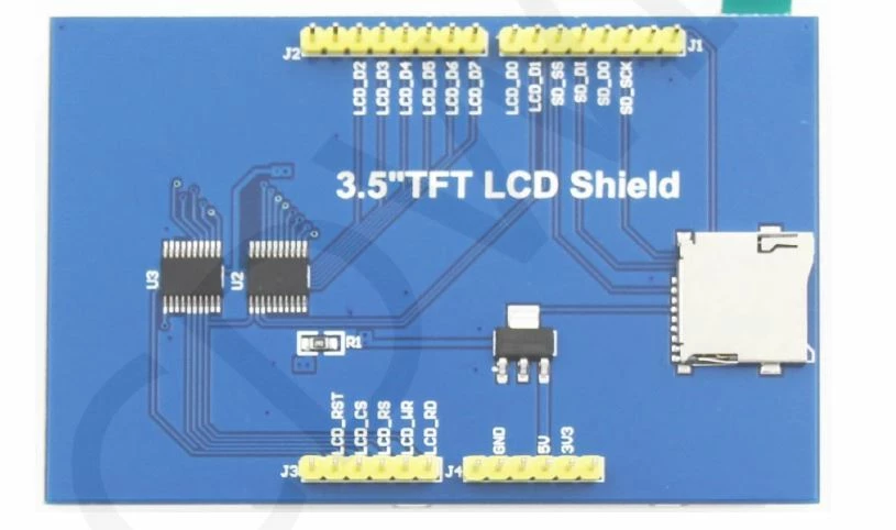

Hi Couple days ago, I tried to interface STM32F030C8 dev. board with TFT display like on the picture with ILI9486 driver Through 8Bit Data line interface . But, it is not Working.
