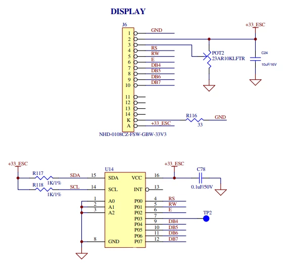

Hi there. I'm trying to configure an LCD display in 4-bit mode, which is connected to an I2C expansion chip. I am able to scan and find the I2C address to send commands to, so I assume that means my I2C handler is set up correctly. However, I am very unfamiliar with programming STM32 still.
I followed some online guides for setup, but when I issue commands to the LCD, nothing happens. There's no initialization in response to the display commands sent, and there's no string that appears on the LCD when sending data. I need some guidance on getting the I2C and LCD to work.
Below are my parts and their associated data sheets, my current code, and I've attached some screenshots of my schematic.
Note: SCL is on pin PB9. SDA is on PB8.

I am still new at programming on this platform. In addition to any answers, if you know of any straightforward resources that will help me learn more, please provide pointers where to find them.
1 reply
Pavel A.
Jul 26, 2022 8:13 PM UTC
Here you can find a helping hand for your learning projects.
