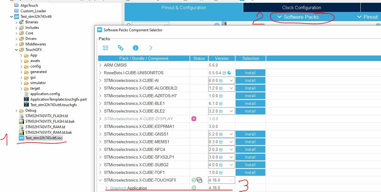

I installed GFXstudio (v4.16 - v4.15 and v4.13) on STM32CubeIDE 1.5.1.
I create a new project (C++), I choose the right uC and I configured all peripherals to
manage an external TFT 480x272 display (via LTDC)
I designed a simple Screen with a picture and 2 buttons, then I generate the code from GFXstudio 4.16 and it works without problems.

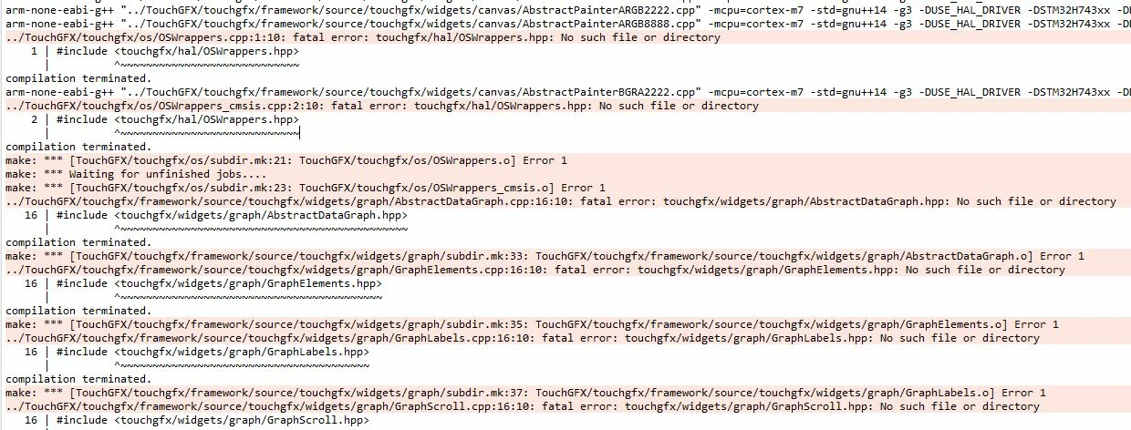

When I try to compile the project on Stm32CubeIDE I see a lots of missing files and patch witch block the compiling process.
Every time I insert a new patch, i receve a new error cause a new file is missing.
I would like to know some simple things to start my first project:
1) Why I must insert all the patch to locate the files needed by project? is it possibile do it automatically?
(some of missing files:
   touchgfx/hal/OSWrappers.hpp: No such file or directory
   touchgfx/widgets/graph/AbstractDataGraph.hpp: No such file or directory
   touchgfx/widgets/graph/GraphElements.hpp: No such file or directory)

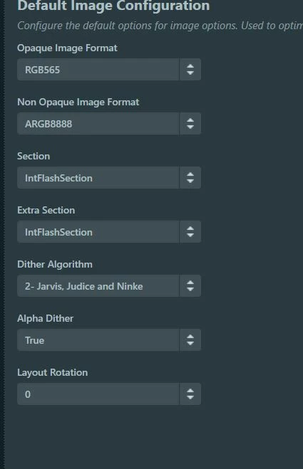

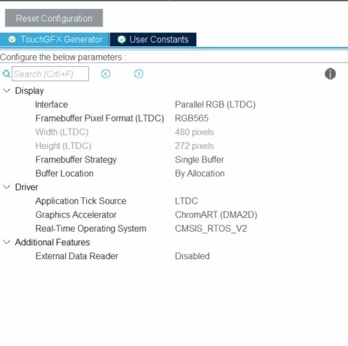

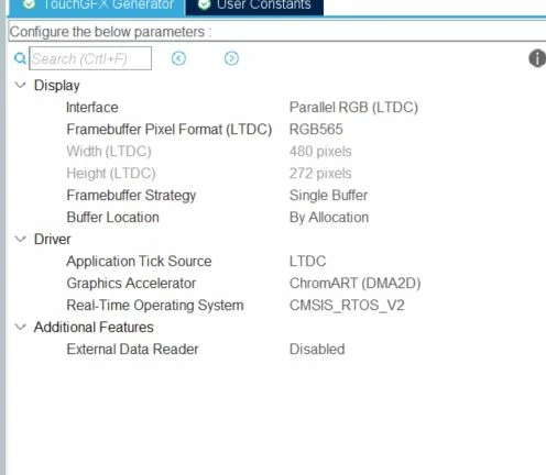

2) I change the setting from gfxStudio to load assets (image and text) from internal FLASH. How I can access to the external resources?
  in other words, I configured also QUADSPI(2) but "external Data Reader" is always not settable.

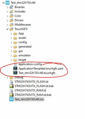

When I said you would have a working project with the H743, I didn't that you could just use the project and change the MCU. I meant that you use this as a reference. Sorry for the misunderstanding.
In other words, you create your project from scratch selecting the right MCU you're using (I recommend using CubeMX for MCU settings and only switch to CubeIDE for compilation and debug purposes because as the name states it is first and foremost an IDE) and then you copy and adapt all the settings from the working project on H743-EVAL along with most of the code. The Application Templates acts as REFERENCE when making a project on custom hardware.
From the look of your project AlgoTouchTest, you didn't refer correctly to the Application template. In your main.c, MX_TouchGFX_Process() or TouchGFX_Task() are nowhere to be seen.
I will repeat myself, but it's essential if you want to achieve something with TouchGFX or ST in general but : refer to example codes. For TouchGFX, these example codes are the Application Templates. By looking at them and the the similarities you should be able to pinpoint what's the problem.
Right now, TouchGFX does not seem to start at all. Either you rename your task from StartDefaultTask  to TouchGFX_Task and set it to weak or you call MX_TouchGFX_Process in your StartDefaultTask before the for loop.
From what you said, it seems you've done that part. After you referred closely to the examples and your code is still hanging somewhere, here is what you need to do : Attach the call stack and any information that could help us understand the issue.
But before that a clean project that looks like one of the Application Template will help you and us a lot to make your project work.

Hi: I have an update.
The problem is only on gfxStudio 4.16 plugin installed on STM32CubeIDE 1.5.1.
Convert the project to gfxStudio 4.15 plugin, all work fine without any compiling errors.
On gfxStudio 4.16 there are some files "corrupted" : the compiler doesn't find "LCD2getPixel" and "LCD2setPixel" because they moved respect the previous gfxStudio 4.15 and instead of "getGraphAreaPaddingRight" the original file contains "getGraphAeraPaddingRight".

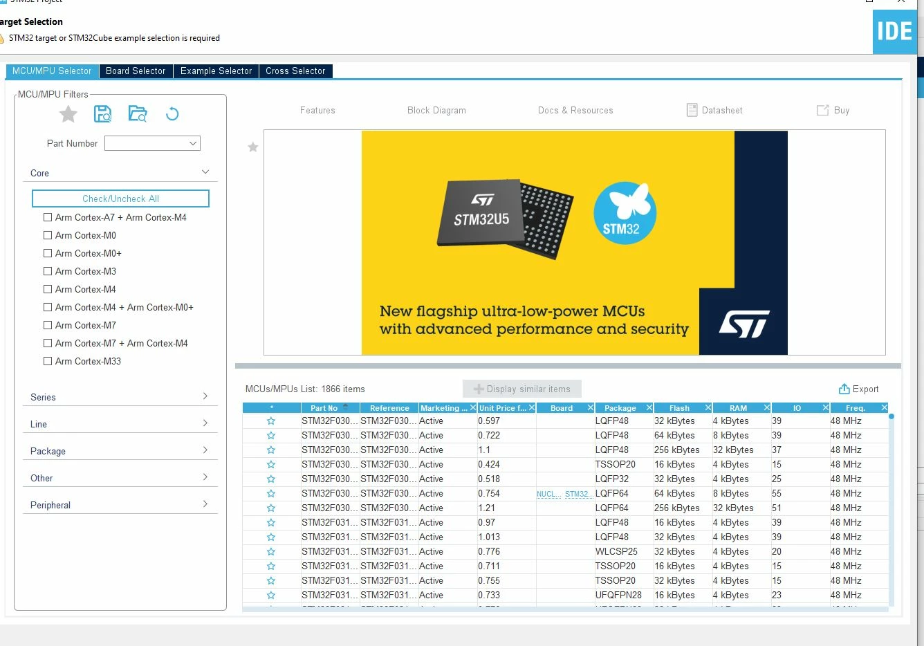

In attachment I inserted an Empty project configurated for STM32H743VIT6. This project has the minimal configuration to active LCD drivers and to show a simple graphic example.
I would like to hint to you to use STM32IDE and create a new "STM32 project"
 0693W000008yLJzQAM.jpgAnd choose your device . Into a second step, you can load the "device configuration tools" to enable and active all the peripherals you need.
When you enable Touch GFX, ide create an empty graphic project.
0693W000008yLJ6QAM.jpgThis is your start point.
All It's very simple. You don't need to do anything else.

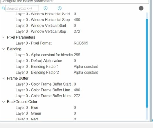

Apr 1, 2021 5:27 PM UTC
0693W000008yYHDQA2.jpgHello MPast.1
Thanks for your help, but i still have some problems.
as you did, i followed all of steps of below as well.
I'm using the TouchGFX 4.15 instead 4.16
1) FREERTOS = I changed some "Config parameters" copying H7B3DKsettings -> DONE
2) FREERTOS = i changed Heap size, I replaced the StartDefaultTask with TouchGFX_Task and increased stack size to 4096 -> -> DONE
3) I checked if TouchGFX_Task function wasn't present MX_TouchGFX_Process(); -> -> DONE
4) on SOFTWARE PACKs--> TOUCHGFX 4.15 = I changed Buffer Location setting to "By Allocation" -> -> DONE
5) on LTDC --> Layer Settings = I changed Layer 0 - Color Frame Buffer Start Address to ZERO -> -> DONE
In TouchGFX Designer i changed to Internal Flash
One last thing that i saw is the files FLASH and RAM ".ld"
