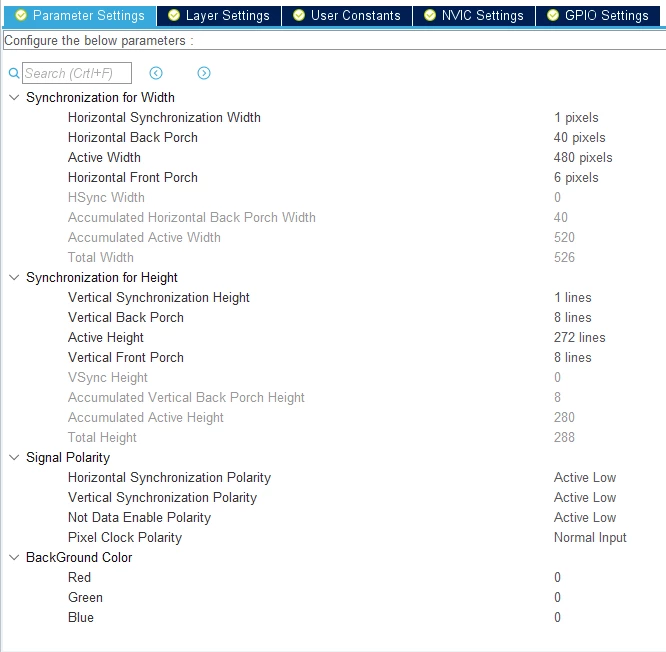

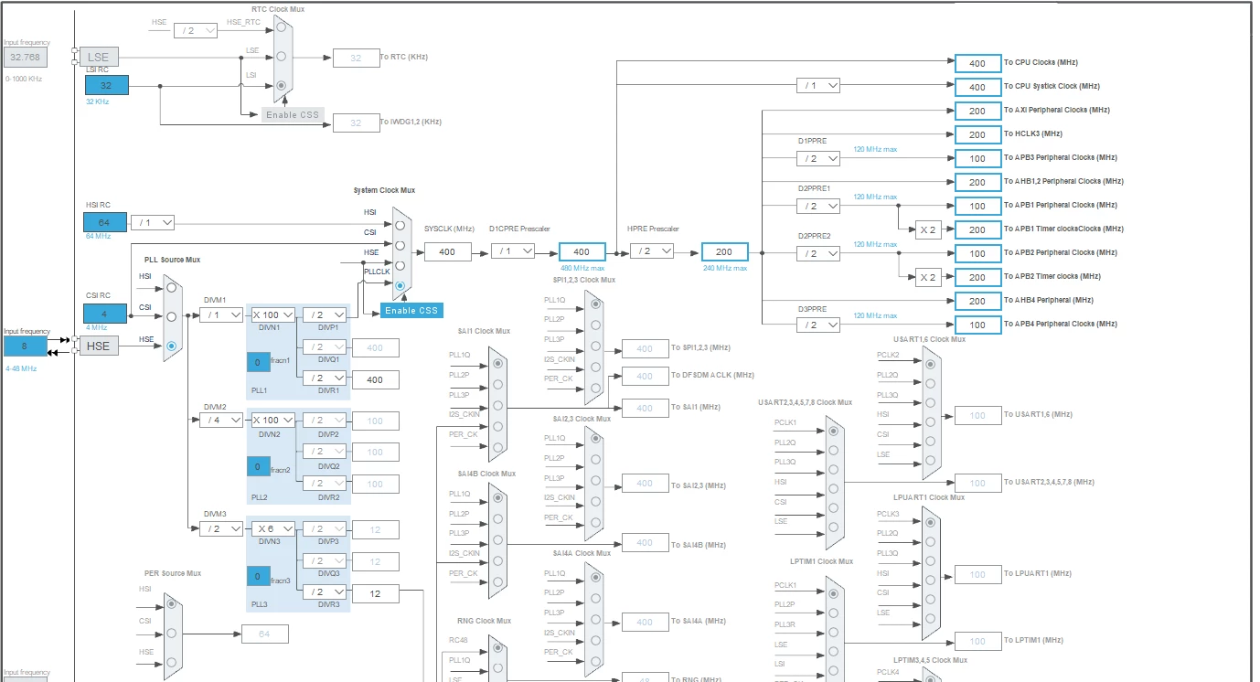

Hello, I'm using STM32H743IIT6 with LTDC configurations and when I'm using internal clock, LTDC works fine but when I use external crystal nothing works . What can be the problem?

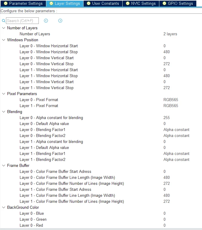

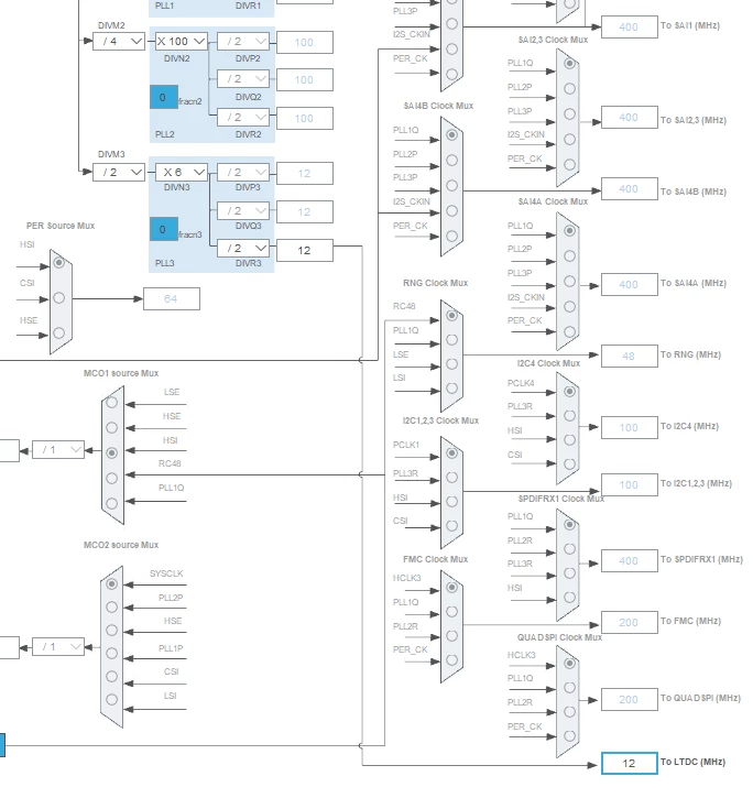

And this are is LTDC configuration and Clock configuration:0693W000004IaWAQA0.png0693W000004IaWKQA0.png

?? Frame buffer start address 0 ?? and why two layers
for your size and dot clock frame rate is 90Hz , isnt to big? Try change 12Mhz to 8MHz...
