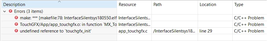

Hi @ECoud.1​,
Downloading your project file I notice that the project is a "C" project. Not a C++ project. Maybe you initially created it as a C project?
You can convert it into a C++ project and all settings from the C Compiler/Linker will be copied/migrated to the corresponding C++ tools.
Right-click on the project > Convert to C++
After doing that, and opening TGFX Designer 4.16.1 and clicking generate, I have all the files needed to successfully compile the project.
But the linking fails since the TouchGFX_Framebuffer needs 750KB RAM and the device only has 320KB...
So, I assume you have to also modify the size of this frame buffer (rely on partial frame buffers, or rely on external RAM depending on what performance you need). I by-passed it by modifying the linker script to set :
RAM  (xrw)  : ORIGIN = 0x20000000,  LENGTH = 1024K
Only to validate that the project could build successfully. I can of course not run this code... =)
