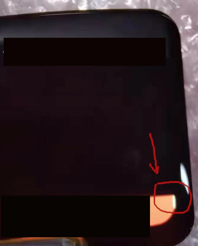

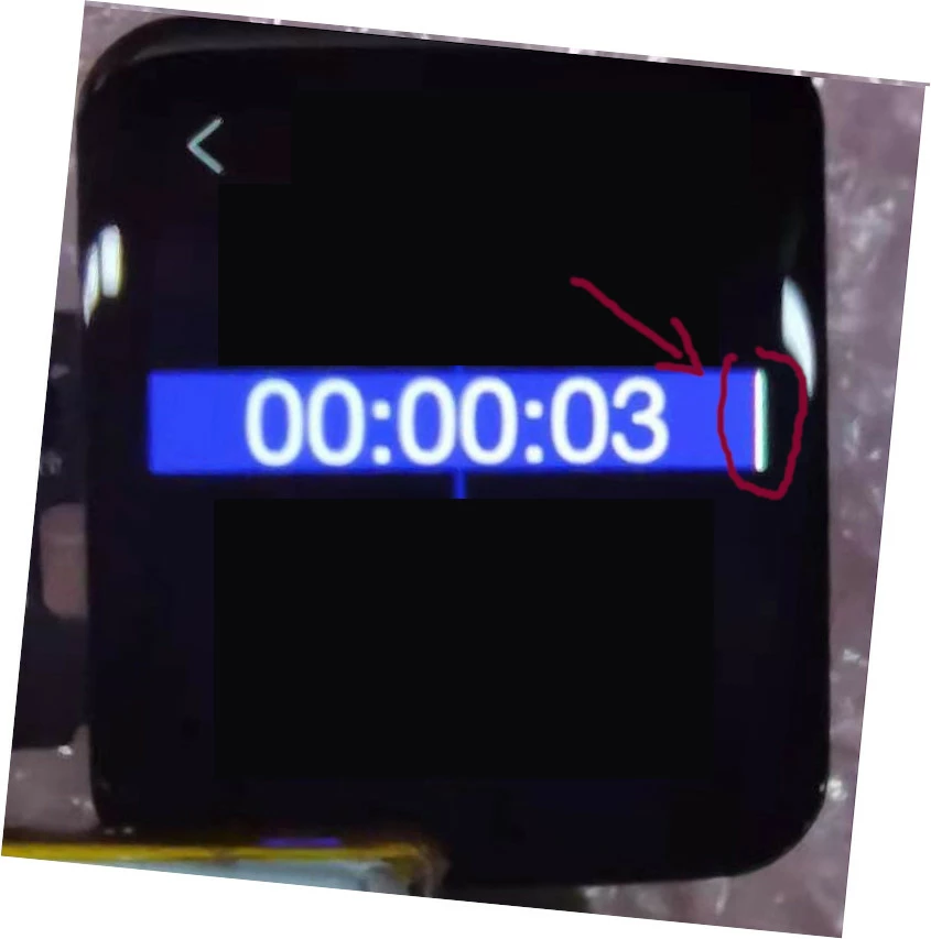

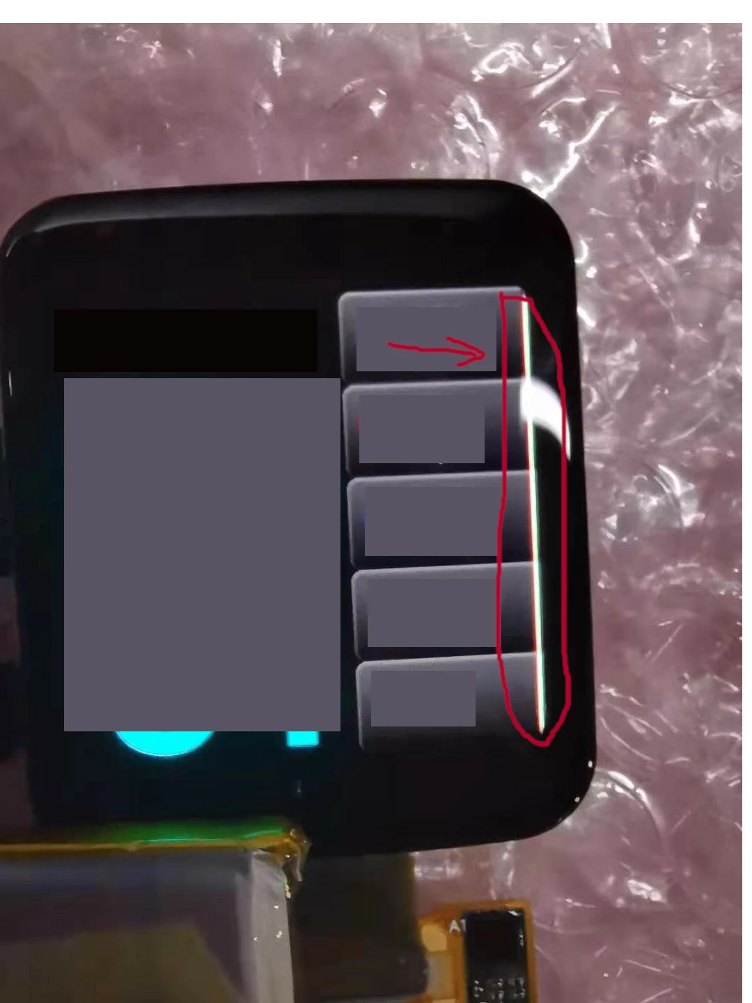

Hello, i hava got a problem with full scrren size controls. Sometimes, there will be a flash line end of the controls. What i suppose to do with this problem?

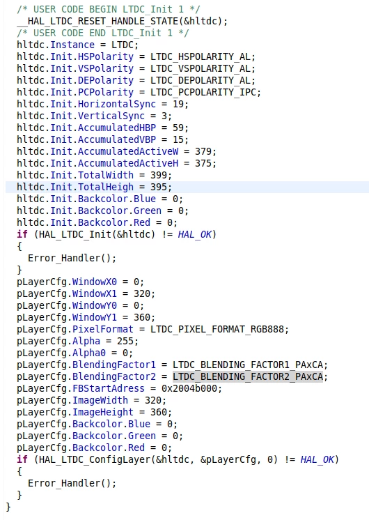

Only RAM is smaller, because when framebuffer start on 0x20048000
RAM must end here.

Here is more possible fails. LTDC framebuffer error in config, Porch data for LCD . Source images converting problem when 565 used...

0693W000006HEuaQAG.pngThis is my LTDC init code. The problem is not always here. Once this problem occurs next to a control that has had a problem, then all the control that has the problem will have this problem again. Is it possible that something is wrong with the screen itself?

320x360x3=345600 and your FBStartAddr is 300k in SRAM , you dont get info how STM you use, Where is your FB ???
