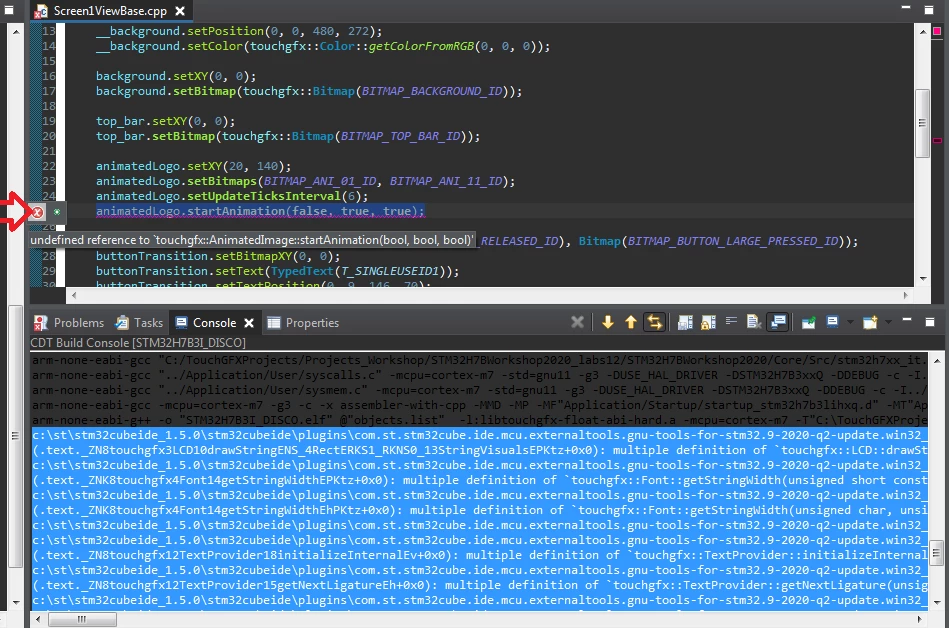

I unzip the project STM32H7BWorkshop2020_labs12 i open the touchGFX project with new version 4.17. I apply  the advice suggested to convert project from vers 4.13 to 4.17 e regenerate the code.
then i open STmCUBE IDE but when i built the project it generates this error:
c:\st\stm32cubeide_1.5.0\stm32cubeide\plugins\com.st.stm32cube.ide.mcu.externaltools.gnu-tools-for-stm32.9-2020-q2-update.win32_2.0.0.202105311346\tools\arm-none-eabi\bin\ld.exe: C:\TouchGFXProjects\Projects_Workshop\STM32H7BWorkshop2020_labs12\STM32H7BWorkshop2020\STM32CubeIDE\Middlewares\ST\touchgfx\lib\core\cortex_m7\gcc\libtouchgfx-float-abi-hard.a(LCD.o): in function `touchgfx::LCD::drawString(touchgfx::Rect, touchgfx::Rect const&, touchgfx::LCD::StringVisuals const&, unsigned short const*, ...)':
(.text._ZN8touchgfx3LCD10drawStringENS_4RectERKS1_RKNS0_13StringVisualsEPKtz+0x0): multiple definition of `touchgfx::LCD::drawString(touchgfx::Rect, touchgfx::Rect const&, touchgfx::LCD::StringVisuals const&, unsigned short const*, ...)'; ./Application/User/generated/Texts.o:C:/TouchGFXProjects/Projects_Workshop/STM32H7BWorkshop2020_labs12/STM32H7BWorkshop2020/TouchGFX/generated/texts/src/Texts.cpp:51: first defined here
c:\st\stm32cubeide_1.5.0\stm32cubeide\plugins\com.st.stm32cube.ide.mcu.externaltools.gnu-tools-for-stm32.9-2020-q2-update.win32_2.0.0.202105311346\tools\arm-none-eabi\bin\ld.exe: C:\TouchGFXProjects\Projects_Workshop\STM32H7BWorkshop2020_labs12\STM32H7BWorkshop2020\STM32CubeIDE\Middlewares\ST\touchgfx\lib\core\cortex_m7\gcc\libtouchgfx-float-abi-hard.a(Font.o): in function `touchgfx::Font::getStringWidth(unsigned short const*, ...) const':
(.text._ZNK8touchgfx4Font14getStringWidthEPKtz+0x0): multiple definition of `touchgfx::Font::getStringWidth(unsigned short const*, ...) const'; ./Application/User/generated/Texts.o:C:/TouchGFXProjects/Projects_Workshop/STM32H7BWorkshop2020_labs12/STM32H7BWorkshop2020/TouchGFX/generated/texts/src/Texts.cpp:14: first defined here
c:\st\stm32cubeide_1.5.0\stm32cubeide\plugins\com.st.stm32cube.ide.mcu.externaltools.gnu-tools-for-stm32.9-2020-q2-update.win32_2.0.0.202105311346\tools\arm-none-eabi\bin\ld.exe: C:\TouchGFXProjects\Projects_Workshop\STM32H7BWorkshop2020_labs12\STM32H7BWorkshop2020\STM32CubeIDE\Middlewares\ST\touchgfx\lib\core\cortex_m7\gcc\libtouchgfx-float-abi-hard.a(Font.o): in function `touchgfx::Font::getStringWidth(unsigned char, unsigned short const*, ...) const':
(.text._ZNK8touchgfx4Font14getStringWidthEhPKtz+0x0): multiple definition of `touchgfx::Font::getStringWidth(unsigned char, unsigned short const*, ...) const'; ./Application/User/generated/Texts.o:C:/TouchGFXProjects/Projects_Workshop/STM32H7BWorkshop2020_labs12/STM32H7BWorkshop2020/TouchGFX/generated/texts/src/Texts.cpp:23: first defined here
c:\st\stm32cubeide_1.5.0\stm32cubeide\plugins\com.st.stm32cube.ide.mcu.externaltools.gnu-tools-for-stm32.9-2020-q2-update.win32_2.0.0.202105311346\tools\arm-none-eabi\bin\ld.exe: C:\TouchGFXProjects\Projects_Workshop\STM32H7BWorkshop2020_labs12\STM32H7BWorkshop2020\STM32CubeIDE\Middlewares\ST\touchgfx\lib\core\cortex_m7\gcc\libtouchgfx-float-abi-hard.a(Font.o):(.rodata._ZTVN8touchgfx4FontE+0x0): multiple definition of `vtable for touchgfx::Font'; ./Application/User/generated/Texts.o:(.rodata._ZTVN8touchgfx4FontE+0x0): first defined here
c:\st\stm32cubeide_1.5.0\stm32cubeide\plugins\com.st.stm32cube.ide.mcu.externaltools.gnu-tools-for-stm32.9-2020-q2-update.win32_2.0.0.202105311346\tools\arm-none-eabi\bin\ld.exe: C:\TouchGFXProjects\Projects_Workshop\STM32H7BWorkshop2020_labs12\STM32H7BWorkshop2020\STM32CubeIDE\Middlewares\ST\touchgfx\lib\core\cortex_m7\gcc\libtouchgfx-float-abi-hard.a(TextProvider.o): in function `touchgfx::TextProvider::initializeInternal()':
(.text._ZN8touchgfx12TextProvider18initializeInternalEv+0x0): multiple definition of `touchgfx::TextProvider::initializeInternal()'; ./Application/User/generated/Texts.o:C:/TouchGFXProjects/Projects_Workshop/STM32H7BWorkshop2020_labs12/STM32H7BWorkshop2020/TouchGFX/generated/texts/src/Texts.cpp:46: first defined here
c:\st\stm32cubeide_1.5.0\stm32cubeide\plugins\com.st.stm32cube.ide.mcu.externaltools.gnu-tools-for-stm32.9-2020-q2-update.win32_2.0.0.202105311346\tools\arm-none-eabi\bin\ld.exe: C:\TouchGFXProjects\Projects_Workshop\STM32H7BWorkshop2020_labs12\STM32H7BWorkshop2020\STM32CubeIDE\Middlewares\ST\touchgfx\lib\core\cortex_m7\gcc\libtouchgfx-float-abi-hard.a(TextProvider.o): in function `touchgfx::TextProvider::getNextLigature(unsigned char)':
(.text._ZN8touchgfx12TextProvider15getNextLigatureEh+0x0): multiple definition of `touchgfx::TextProvider::getNextLigature(unsigned char)'; ./Application/User/generated/Texts.o:C:/TouchGFXProjects/Projects_Workshop/STM32H7BWorkshop2020_labs12/STM32H7BWorkshop2020/TouchGFX/generated/texts/src/Texts.cpp:32: first defined here
c:\st\stm32cubeide_1.5.0\stm32cubeide\plugins\com.st.stm32cube.ide.mcu.externaltools.gnu-tools-for-stm32.9-2020-q2-update.win32_2.0.0.202105311346\tools\arm-none-eabi\bin\ld.exe: ./Application/User/TouchGFX/target/TouchGFXHAL.o:(.rodata._ZTV11TouchGFXHAL+0x4c): undefined reference to `touchgfx::HAL::blitCopyWord(unsigned short const*, unsigned short, unsigned short, unsigned short, unsigned short, unsigned short, unsigned short)'
c:\st\stm32cubeide_1.5.0\stm32cubeide\plugins\com.st.stm32cube.ide.mcu.externaltools.gnu-tools-for-stm32.9-2020-q2-update.win32_2.0.0.202105311346\tools\arm-none-eabi\bin\ld.exe: ./Application/User/TouchGFX/target/TouchGFXHAL.o:(.rodata._ZTV11TouchGFXHAL+0x50): undefined reference to `touchgfx::HAL::blitFillWord(unsigned short, unsigned short, unsigned short, unsigned short, unsigned short, unsigned short)'
c:\st\stm32cubeide_1.5.0\stm32cubeide\plugins\com.st.stm32cube.ide.mcu.externaltools.gnu-tools-for-stm32.9-2020-q2-update.win32_2.0.0.202105311346\tools\arm-none-eabi\bin\ld.exe: ./Application/User/TouchGFX/target/generated/TouchGFXConfiguration.o:(.rodata._ZTV19FrontendApplication[_ZTV19FrontendApplication]+0x30): undefined reference to `touchgfx::Application::requestRedraw()'
c:\st\stm32cubeide_1.5.0\stm32cubeide\plugins\com.st.stm32cube.ide.mcu.externaltools.gnu-tools-for-stm32.9-2020-q2-update.win32_2.0.0.202105311346\tools\arm-none-eabi\bin\ld.exe: ./Application/User/TouchGFX/target/generated/TouchGFXConfiguration.o:(.rodata._ZTV23FrontendApplicationBase[_ZTV23FrontendApplicationBase]+0x30): undefined reference to `touchgfx::Application::requestRedraw()'
c:\st\stm32cubeide_1.5.0\stm32cubeide\plugins\com.st.stm32cube.ide.mcu.externaltools.gnu-tools-for-stm32.9-2020-q2-update.win32_2.0.0.202105311346\tools\arm-none-eabi\bin\ld.exe: ./Application/User/TouchGFX/target/generated/TouchGFXConfiguration.o:(.rodata._ZTVN8touchgfx14MVPApplicationE[_ZTVN8touchgfx14MVPApplicationE]+0x30): undefined reference to `touchgfx::Application::requestRedraw()'
c:\st\stm32cubeide_1.5.0\stm32cubeide\plugins\com.st.stm32cube.ide.mcu.externaltools.gnu-tools-for-stm32.9-2020-q2-update.win32_2.0.0.202105311346\tools\arm-none-eabi\bin\ld.exe: ./Application/User/TouchGFX/target/generated/TouchGFXGeneratedHAL.o:(.rodata._ZTV20TouchGFXGeneratedHAL+0x4c): undefined reference to `touchgfx::HAL::blitCopyWord(unsigned short const*, unsigned short, unsigned short, unsigned short, unsigned short, unsigned short, unsigned short)'
c:\st\stm32cubeide_1.5.0\stm32cubeide\plugins\com.st.stm32cube.ide.mcu.externaltools.gnu-tools-for-stm32.9-2020-q2-update.win32_2.0.0.202105311346\tools\arm-none-eabi\bin\ld.exe: ./Application/User/TouchGFX/target/generated/TouchGFXGeneratedHAL.o:(.rodata._ZTV20TouchGFXGeneratedHAL+0x50): undefined reference to `touchgfx::HAL::blitFillWord(unsigned short, unsigned short, unsigned short, unsigned short, unsigned short, unsigned short)'
c:\st\stm32cubeide_1.5.0\stm32cubeide\plugins\com.st.stm32cube.ide.mcu.externaltools.gnu-tools-for-stm32.9-2020-q2-update.win32_2.0.0.202105311346\tools\arm-none-eabi\bin\ld.exe: ./Application/User/generated/Screen1ViewBase.o: in function `Screen1ViewBase::Screen1ViewBase()':
C:/TouchGFXProjects/Projects_Workshop/STM32H7BWorkshop2020_labs12/STM32H7BWorkshop2020/TouchGFX/generated/gui_generated/src/screen1_screen/Screen1ViewBase.cpp:25: undefined reference to `touchgfx::AnimatedImage::startAnimation(bool, bool, bool)'
c:\st\stm32cubeide_1.5.0\stm32cubeide\plugins\com.st.stm32cube.ide.mcu.externaltools.gnu-tools-for-stm32.9-2020-q2-update.win32_2.0.0.202105311346\tools\arm-none-eabi\bin\ld.exe: ./Application/User/generated/Screen1ViewBase.o: in function `touchgfx::TextButtonStyle<touchgfx::ImageButtonStyle<touchgfx::ClickButtonTrigger> >::setText(touchgfx::TypedText)':
C:/TouchGFXProjects/Projects_Workshop/STM32H7BWorkshop2020_labs12/STM32H7BWorkshop2020/STM32CubeIDE/Debug/../../Middlewares/ST/touchgfx/framework/include/touchgfx/containers/buttons/TextButtonStyle.hpp:59: undefined reference to `touchgfx::TextArea::setTypedText(touchgfx::TypedText const&)'
collect2.exe: error: ld returned 1 exit status
make: *** [makefile:92: STM32H7B3I_DISCO.elf] Error 1
Why?
Also when unzipped folder STM32H7BWorkshop2020_labs123 i see the some error about temperatureBar.setXY. It seem that not generate something.. and compiler print out an undefine reference in both the projects..

I dont check this concrete, but when you upgrade TGFX creates backup and IDE sometimes mix files. Then good practice is delete backup folder...
Second step is generate code in TGFX designer without error and in IDE use CLEAN and refresh project.
And final step is correct changed or obsolete function that in new version not exist. Here for example animationlogo need other method to start anim.
And if you plan use ioc file additional steps is requiáred for update software package TGFX...

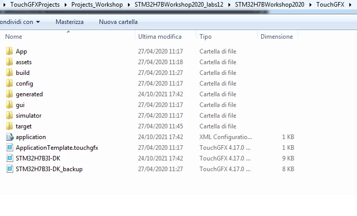

EMir.1
EMir.1Author
October 24, 2021
0693W00000FDZXGQA5.png@MM.1 thanks for your answer.
I don't understand where is the backup folder that you told me. About TouchGFX Designer i have installed only vers 4.0.17.
Did you told me the specific folder in the project where there are again backup files?
please, tell me the path where i can find these.. (i share the touchGfx folder image)

MM..1
Chief III
October 25, 2021
Try in Middlewares\ST\
and versions is 4.17 and 4.13 FYI
And if you plan use ioc file in your project folder, then in this file is coded used version TGFX and generating any change in MX plugin overwrites your external upgrade 4.17 back to 4.13 usw

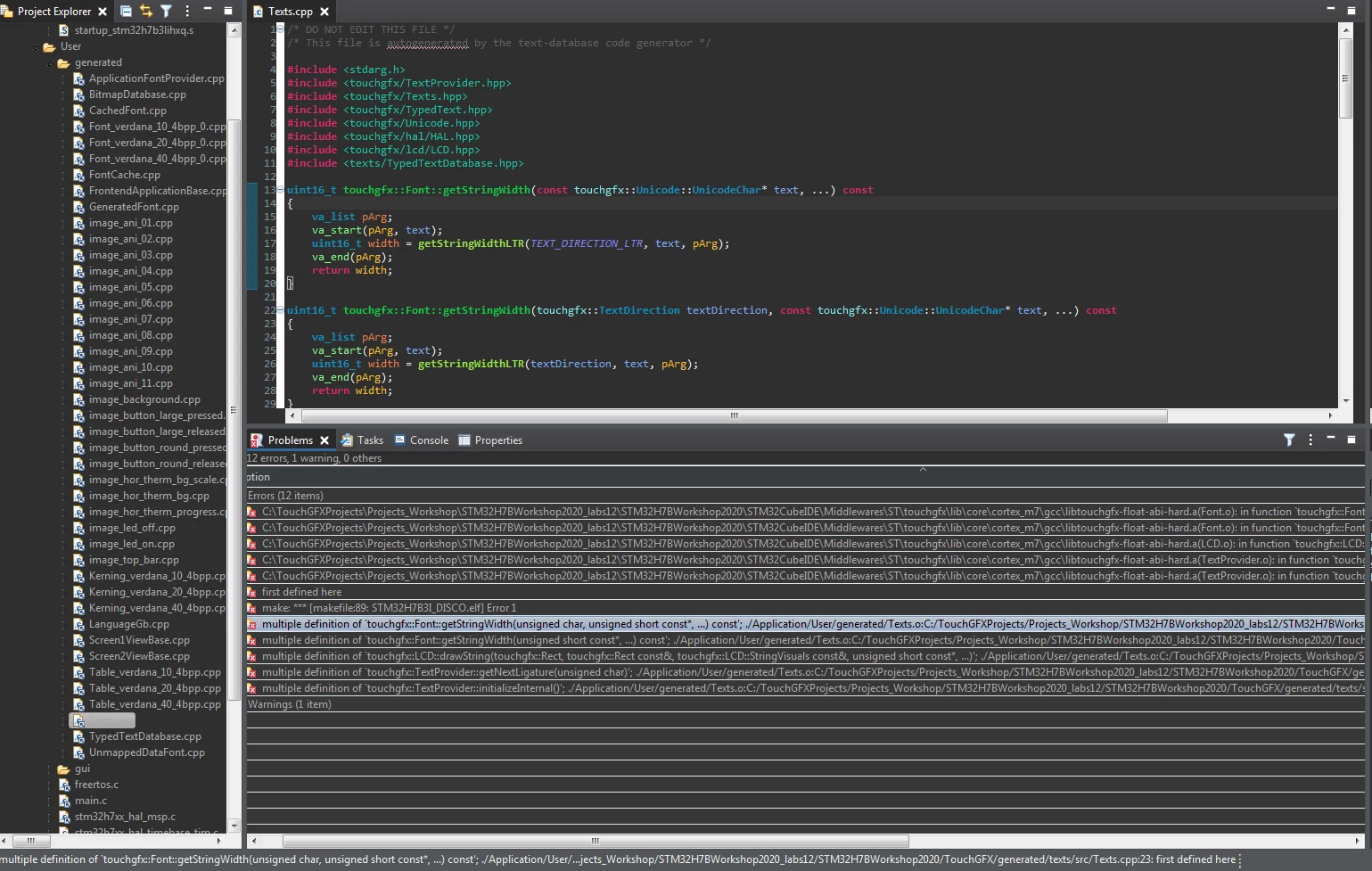

EMir.1
EMir.1Author
October 25, 2021
Hello Jiri,
I follow your procedure.. but nothing..
The version of the generator is already in v 4.17 ( v 4.13 is not yet available), so i re-generate the original project..
i also remove the folder touchgfx_backup in the folder middleware like suggested by MM.1 but nothing the errors are still present..
make: *** [makefile:89: STM32H7B3I_DISCO.elf] Error 1
i attach the image with the list they comes from middleware\ST\touchgfx\lib\core\cortex_m7gcc\libtouchgfx-float-abi-hard.a file..
thanks

MM..1
Chief III
October 26, 2021
Linker say you where is problem ... duplicate definition ... seems upgrade from 13 to 17 isnt complete.
For beginer i dont recommend upgrade, simply go back to start unzip workshop import project to IDE and build. Dont open TouchGFX or download and use 13

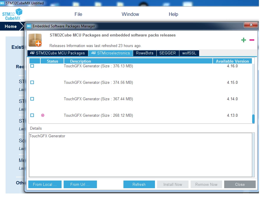

Sorry MM1,0693W00000FDprlQAD.png i'm not explain myself well.. the touch GFX 4.13.0 inside CubeMX in not longer available..
Romain DIELEMAN
October 27, 2021
The version 4.13 can be downloaded from the ST website.
But to be fair I don't recommend using it. There were changes to some important fonctions since 4.13 which would require some manual change to that project, it would be better to follow the workshop using TouchGFX 4.17 directly (or 4.18 which was released last week) and use the TouchGFX Board Setup (new name for Aplication Template) for the STM32H7B3-dk.
