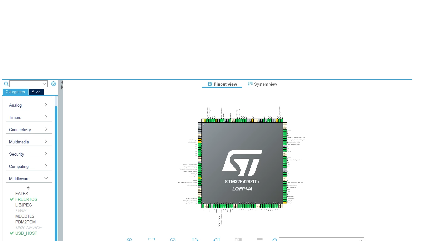

hello i am going to start graphic project on stm32 discovery board but altough my stm32cubemx is latest virsion but i dont have graphic icon in middleware of stm32cubemx can anyone help me thank you so mutch

It looks like you've already assigned a lot of pins that are needed to do graphics. But regardless of this, at least LTDC is necessary for graphics applications, which can be found under category Multimedia or under A->Z.
However, if you've never developed a graphics application on the DISCOVERY, you should start with TouchGFX.

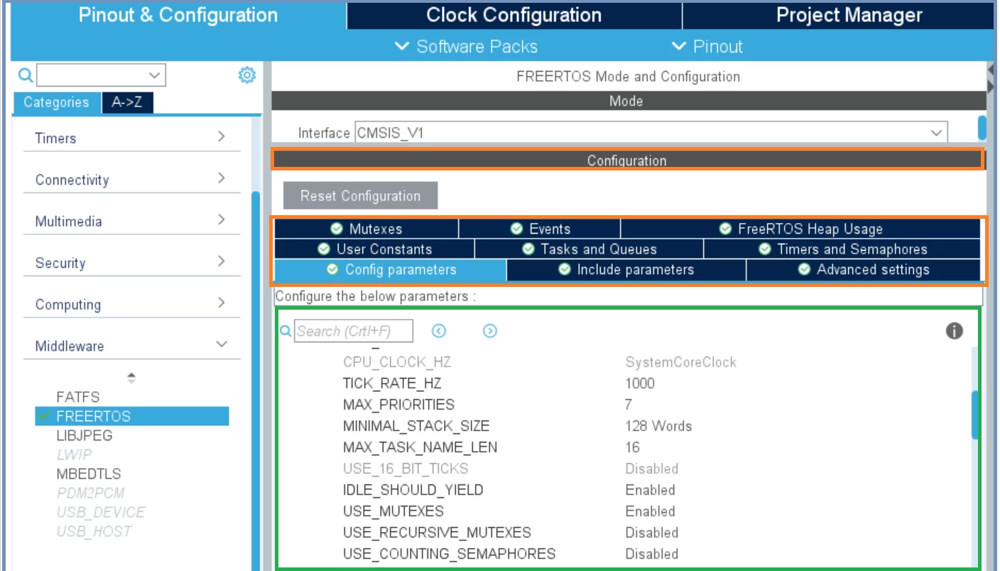

Hello @Msade.1​
Thanks for your question,
Actually, STM32CubeMX is a graphical tool that allows a very easy configuration of STM32 MCU and MPU, as well as the generation of the corresponding initialization C code through a step-by-step process.
In fact, the graphical configuration includes the activation of the middleware (same for the IPs) and the settings of its parameters graphically (using check-boxes and options with enabled/disabled choice...) to have a generated code that contains the necessary functions with the configuration made through CubeMX.
