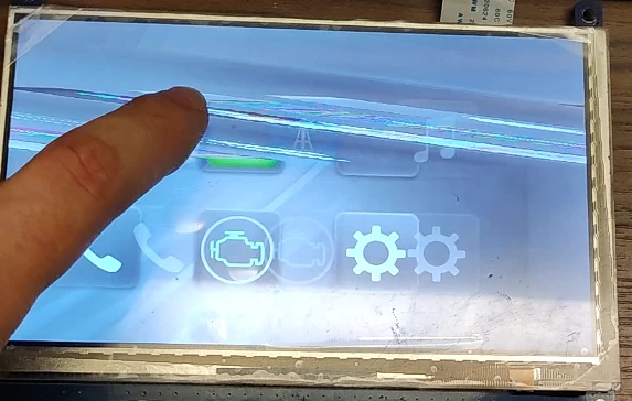

Hello Here is my problem. When I want to press a button to change window, lines appear. (view the photo) CubeIde V 1.7 touchgfx 1.8.1 double buffer external sdram and qspi Do you have a lead. Thank you

Hello @cVass.1​ ,
Did you try with Single buffer ?
How did you set up your external RAM ?
/Yoann
