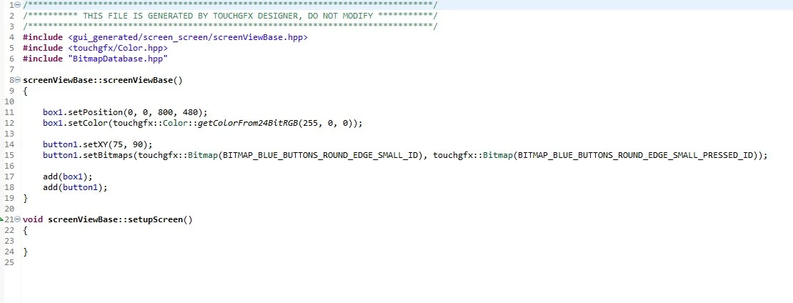

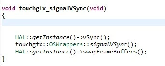

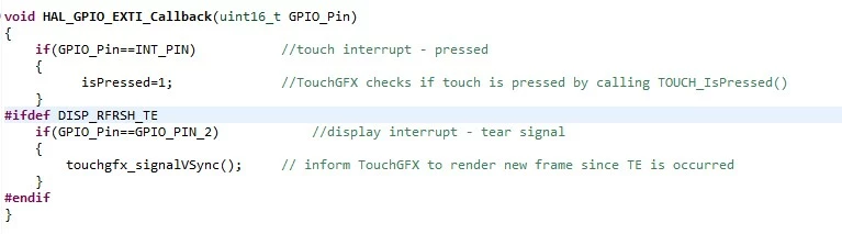

@Flemming Gram CHRISTENSEN​  Yes, there is.0693W000006G7RyQAK.jpg0693W000006G7RUQA0.jpg0693W000006G7QqQAK.jpg0693W000006G7QWQA0.jpg

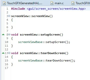

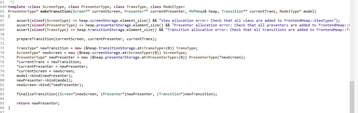

I should also mention that my code doesn't fall into the functions screenViewBase :: screenViewBase () and screenView :: screenView (). Can you explain how to access these functions with interrupt? @Flemming Gram CHRISTENSEN​  @Martin KJELDSEN​ 0693W000006G8N4QAK.jpg0693W000006G8MfQAK.jpg0693W000006G8MVQA0.jpg
I could access these functions in my works with the STM32F429's LTDC screen. But as there is a problem with my FMC configurations, I cannot access these functions via interrupt.

If you're not getting touchgfx_signalVsync() called, then TouchGFX isn't running and nothing will happen on screen. Check out the F412 AT for inspiration on FMC config..

You are right Martin. With a LTDC display you get a "refresh" signal from the LTDC controller. With a display on FMC you normally use an external signal from the display (an extra line going from the display to the MCU). This is asserted by the display when a refresh starts.
The standard procedure is to hook the external interrupt to this line, and then start TouchGFX drawing. I.e. calling touchgfx_signalvsync (in above pictures) from the interrupthandler.
