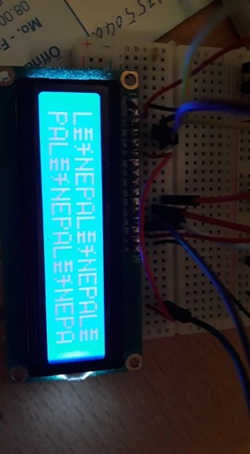

Hello everyone, I am interfacing stm32f103 to LCD44780 to display character in one location (1,1) but it shows in whole pixel 16x2. could you give me idea ?

void LCD_Enable()
HAL_GPIO_WritePin(GPIOB,GPIO_PIN_14,1);
HAL_Delay(1);
HAL_GPIO_WritePin(GPIOB,GPIO_PIN_14,0);
HAL_Delay(1);
void LCD_Send4Bit(unsigned char Data)
HAL_GPIO_WritePin(GPIOA,GPIO_PIN_8,Data&0x01);
HAL_GPIO_WritePin(GPIOA,GPIO_PIN_9,(Data>>1)&0x01);
HAL_GPIO_WritePin(GPIOA,GPIO_PIN_10,(Data>>2)&0x01);
HAL_GPIO_WritePin(GPIOA,GPIO_PIN_11,(Data>>3)&0x01);
void LCD_SendCommand(unsigned char command)
LCD_Send4Bit(command >>4);/* Gui 4 bit cao */
LCD_Enable();
LCD_Send4Bit(command); /* Gui 4 bit thap*/
LCD_Enable();
void LCD_Clear()
  LCD_SendCommand(0x01);
 HAL_Delay(1000);
/* USER CODE END 0 */
void LCD_Init()
LCD_Send4Bit(0x00);
 HAL_GPIO_WritePin(GPIOB,GPIO_PIN_12,0);
LCD_Send4Bit(0x03);
LCD_Enable();
LCD_Enable();
LCD_Enable();
LCD_Send4Bit(0x02);
LCD_Enable();
//LCD_SendCommand(0x33);
   //HAL_Delay(100);
//LCD_SendCommand(0x32);
//HAL_Delay(500);
LCD_SendCommand(0x28); // giao thuc 4 bit, hien thi 2 hang, ki tu 5x8
//HAL_Delay(500);
//LCD_SendCommand(0x01);
//HAL_Delay(500);
//LCD_SendCommand(0x06); // cho phep hien thi man hinh
//HAL_Delay(500);
LCD_SendCommand(0x0C); // tang ID, khong dich khung hinh
//HAL_Delay(500);
LCD_SendCommand(0x06); // xoa toan bo khung hinh
LCD_SendCommand(0X01);
//HAL_Delay(500);
void LCD_PutChar(unsigned char Data)
 HAL_GPIO_WritePin(GPIOB,GPIO_PIN_12,1);
  LCD_SendCommand(Data);
 HAL_GPIO_WritePin(GPIOA,GPIO_PIN_12,0);
void LCD_Puts(char *s)
//LCD_Gotoxy(x,y);
while (*s){
    LCD_PutChar(*s);
    s++;
void LCD_Gotoxy(unsigned char x, unsigned char y)
  unsigned char address;
    if(!y)address=(0x80+x);
    else address=(0xC0+x);
    LCD_SendCommand(address);

 LCD_Init();
 //LCD_Gotoxy(1,1);
    // LCD_Puts("NEPAL");
 while (1)
 /* USER CODE END WHILE */
 /* USER CODE BEGIN 3 */
 LCD_Gotoxy(1,1);
     LCD_Puts("NEPAL");
 HAL_Delay(1500);
     LCD_Clear();
