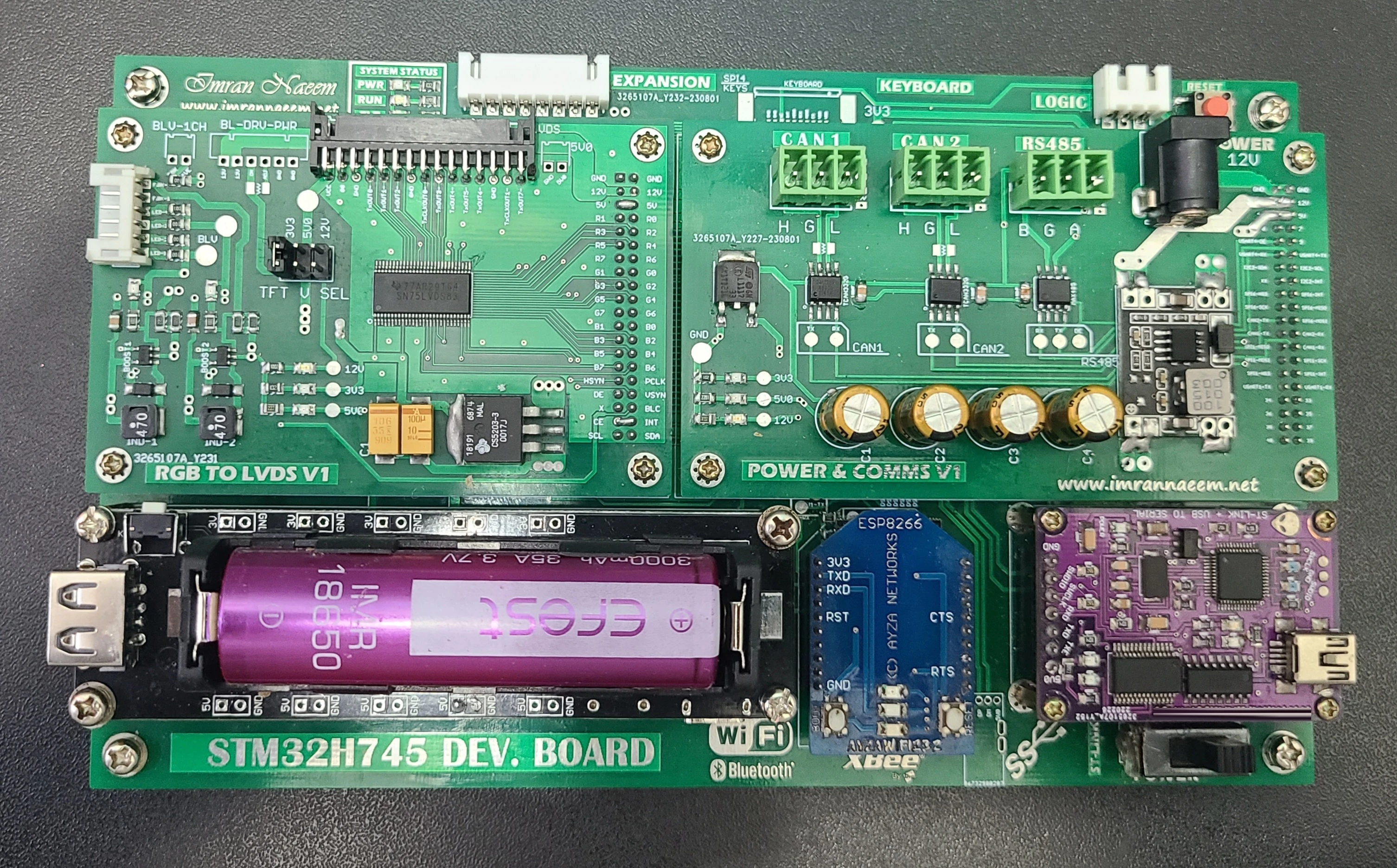

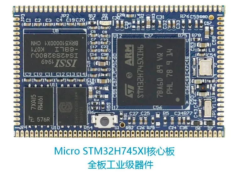

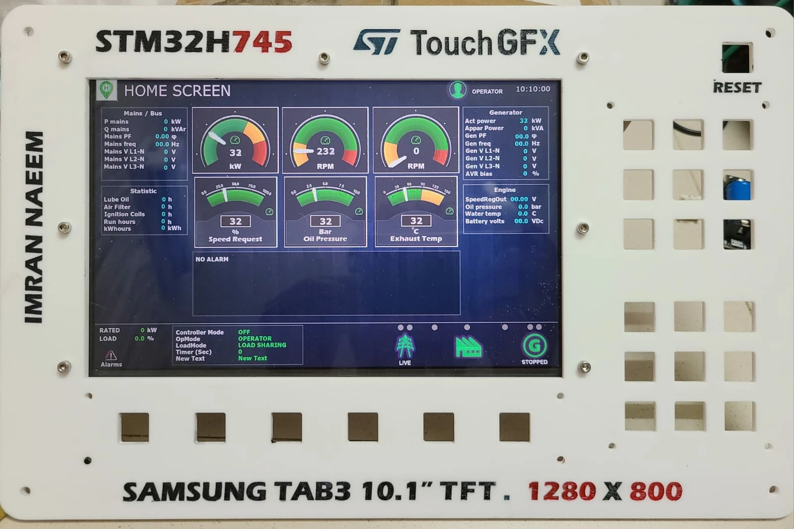

Presently I'm working on STM32H745 SOM and Samsung Tab3 10.1" 1280X800 TFT. Its a custom designed board.
regards
INaee.1

Dec 21, 2023 12:27 AM UTC
Hello. INaee.1
When you were using the wave share board , how did you work around the QUADSPI being on the same pins as the touch screen controller. as I am having great trouble trying to resolve this.
Also did you have a loader file for the Quadspi flash?
Thank You
Greg.
PS: amazing work on your Samsung display project, very impressive.
