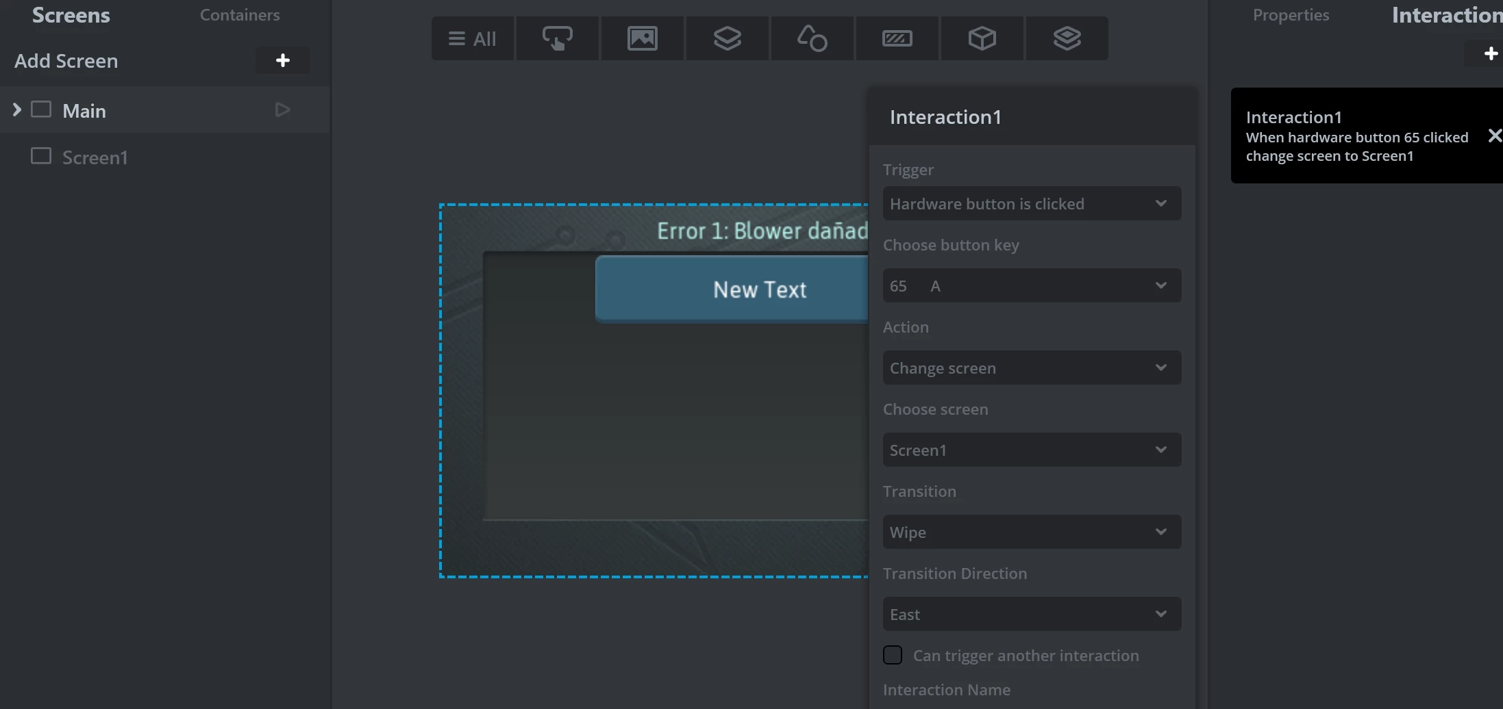

I have been trying to implement the functionality to change the currently active screen on TouchGFX using a hardware button with no luck so far.
I'm using an STM32H743zit6.

Button setup in TouchGFX:

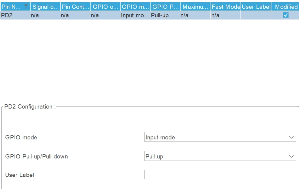

And here is how the button is configured in the ioc file:

void StartUpScreenViewBase::handleKeyEvent(uint8_t key)
 if(1 == key)
 //Interaction1
 //When hardware button 1 clicked change screen to FFTScreen
 //Go to FFTScreen with no screen transition
 application().gotoFFTScreenScreenNoTransition();
Is it that I need to call "application().gotoFFTScreenScreenNoTransition();" from another place in my code?

Jan 9, 2025 9:26 AM UTC
Hi thanks for the reply,
I have tried setting the hardware button up in this way and the screen changes as expected in the simulator.
I also know the hardware button is working as I have another button used for saving images to a USB that works correctly.
However, if you have any suggestions on how to call the change screen functions through code even without pressing a button that would be great too (for example calling it after a short delay in the main while loop).

Josh_W020AuthorBest answer
Jan 16, 2025 9:48 AM UTC
HI,
Thought I'd update this incase anyone else is having the same issue.
In my project I am using an internal framebuffer. In order to set this up I followed this guide made by STM: https://support.touchgfx.com/docs/development/board-bring-up/how-to/03-display-internal
In the guide it specifically states to add the line:
 HAL_LTDC_ProgramLineEvent(&hltdc,0);
to the stm32h7xx_it.c file. However, adding this line will prevent tick from updating? So my tick function was only called once on startup and this if statement never checked:
if (HAL_GPIO_ReadPin(GPIOD, GPIO_PIN_2) == GPIO_PIN_RESET)
		static_cast<FrontendApplication*>(Application::getInstance())->handleKeyEvent('A');
 Removing that line from stm32h7xx_it.c fixed the issue and now tick updates as expected. Just out of curiosity if anyone can explain a bit of the reasoning behind this that would be great.
