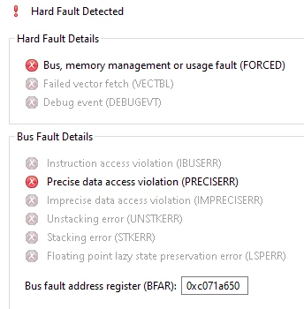

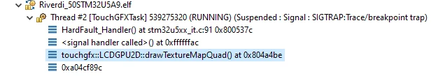

Hello All,
I am new to the STM32 Community. I started working on a new project that involves an STM32u5A9. And a Riverdi Screen.
Riverdi_50STM32U5A9.
After building my project in debug mode, I am receiving intermittent Hardfaults, which the debugger says is from touchgfx. Unfortunately I am not receiving a full stack trace. See Below.
I have tried chasing the Address of the hardfault, but that did not bear any fruit either. It seems the BFAR is an invalid address...
The issue can happen anywhere from 10 seconds after bootup to 24 hours. Making this extremely difficult to debug.
I have tried increasing the stack size for the touchgfx task. and disabling all tasks other than touchgfx.
Has anyone experienced this before or have suggestions on how I can proceed?
STM32CubeIDE1.15.1
TouchGFX Designer - 4.23.2
Thanks
